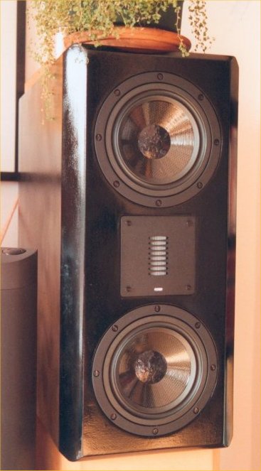

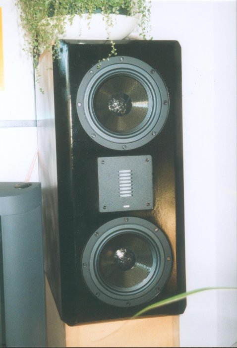

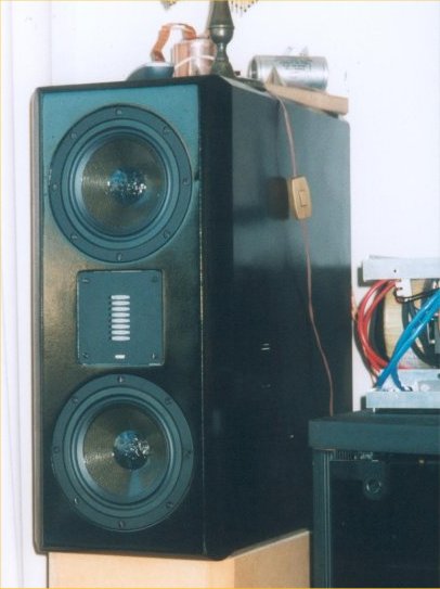

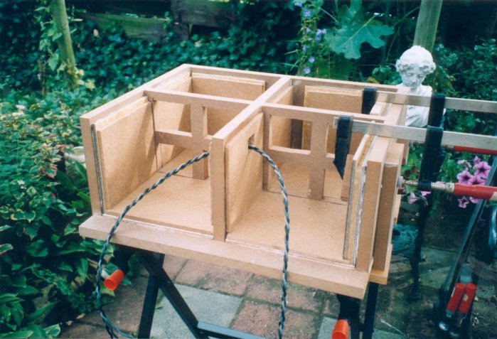

Here I will present bit by bit my almost finished new loudspeakers.
They are based on the Intertechnik Eton Empire satelite speakers. The bass-department will follow later.
Here is a link: http://www.intertechnik.de/

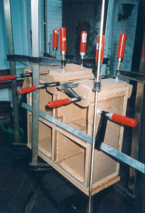

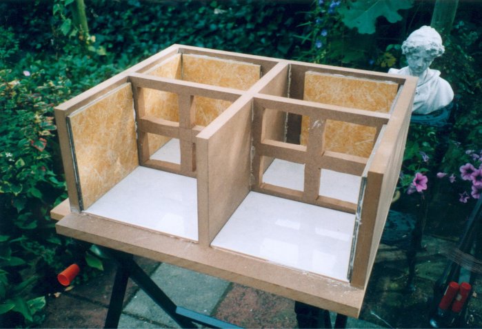

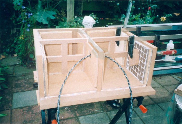

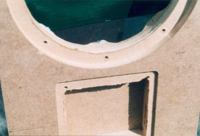

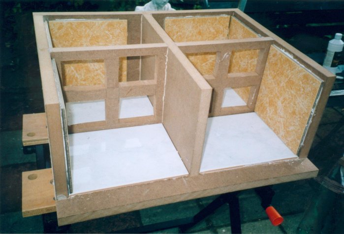

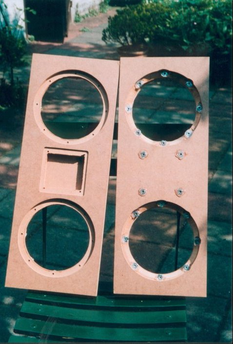

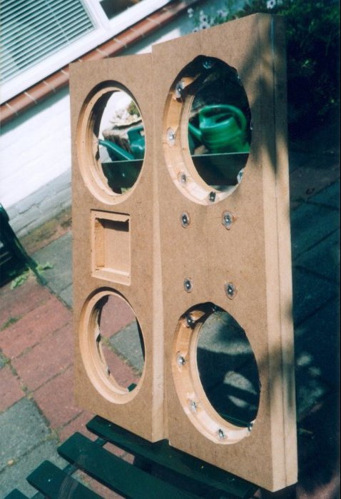

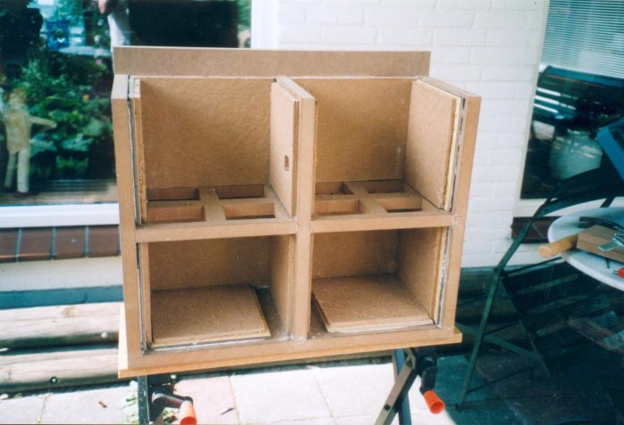

What is special about my implementation is the use of ceramic tiles on the inside of the MDF housing.
Here are some pictures of its construction:

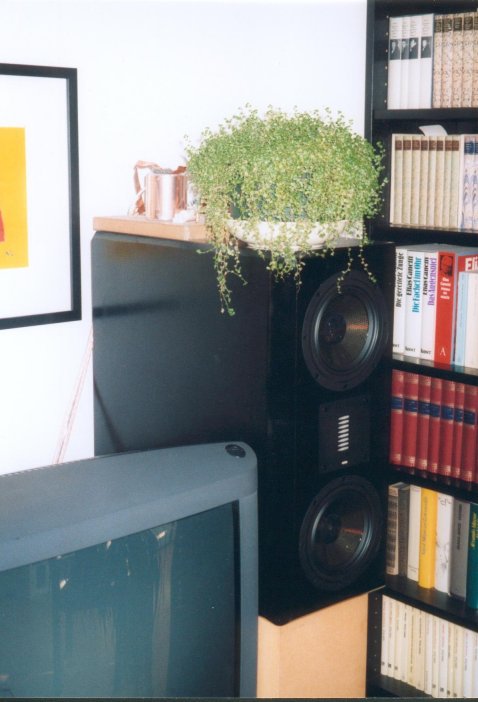

faustian bargin said:
how much do they weigh? i bet the tiles added a lot of mass...? i also bet the walls *really* pass the 'knock' test!
/andrew
Hi Andrew,
They weigh about 45 Kg a piece.
And yes, they are really dead! No reseonances at al...
This does inflict the sound; less "warmth" because of absence of colouring thruogh housing-resonance. This must then be compensated by the filtering. Yet, the truefull midrange is worth all the trouble.
