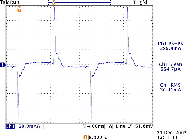

It would probably confer minimal advantage in that situation. But, like me, you might be surprised at how not-quiet your quiet environment is, especially with the advent of CFL lighting.
Bzzz
One of the worst offenders for mains noise near audio equipment is ... ... audio equipment. It's all those capacitor input power supplies and saturating mains transformers. And you'd be amazed how difficult it is to get an active crossover system free of buzz. Input transformers can really help.
And here's the current waveform for a 9W compact fluorescent lamp...
