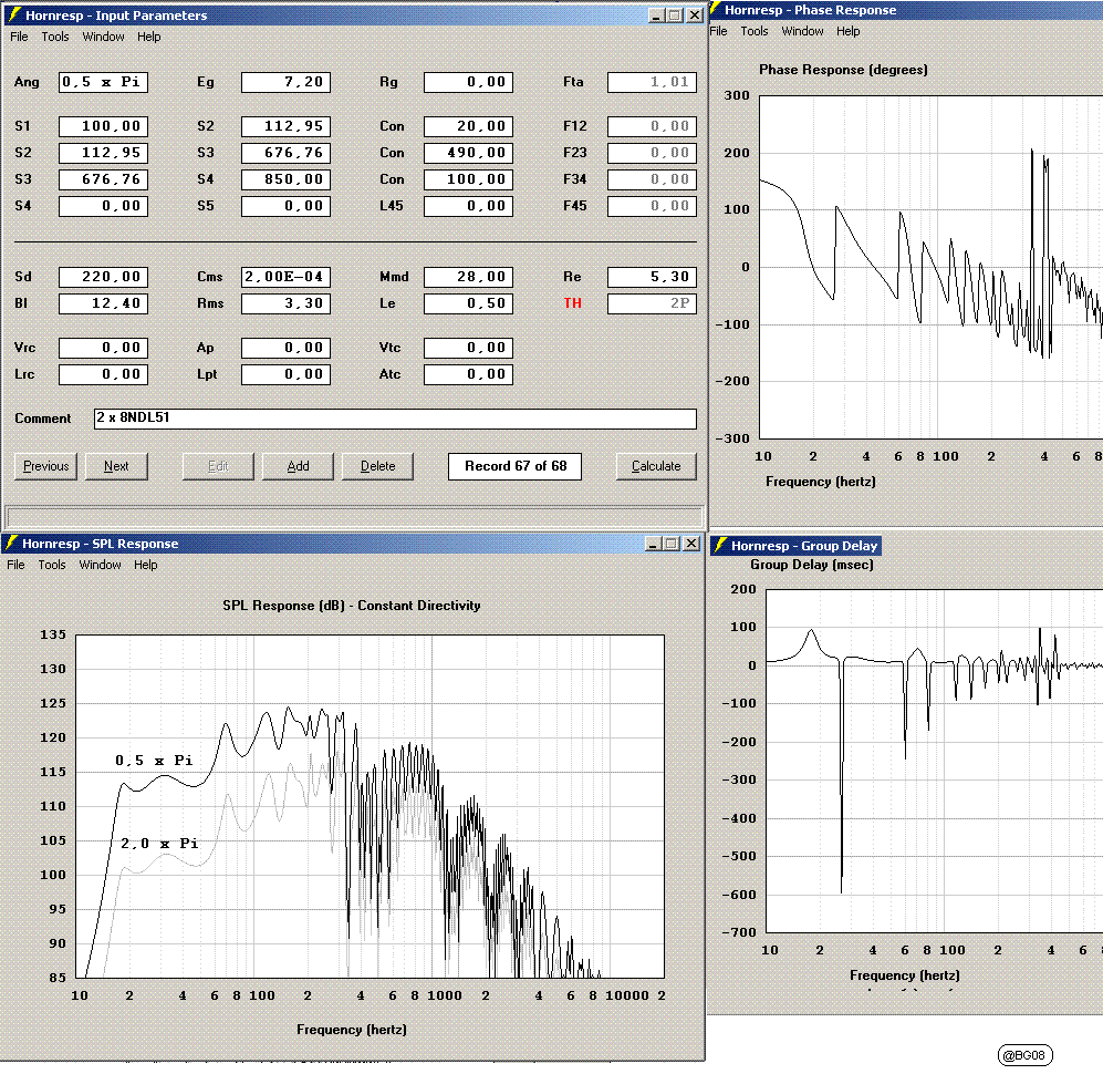

I think this is an interesting concept and so I tried to model a diy version.
I'm thinking of using two B&C 8NDL51 drivers. They have a 7 mm xmax which I think should be enough for my small living room.
Planned layout +/- 120 x120 x 25cm:
Respons graph in Akabak with quarter wave resonating tube at 65Hz and 60Hz low pass:
Hornresponse input:
So what do you think? Will it work? Any design faults?

I didnt sim it, but 7mm xmax sounds really low for this low tuning. Check at what input power it runs out of excursion.
Yes the power handling of this is not so high.
It runs out of xmax at only 12V rms
This should give around 118dB max with corner placement.
Would this be enough or should I better be looking for a more high excursion car audio driver? How would these car drivers compare on a distortion level against the PA driver I'm using now?

Any design faults?

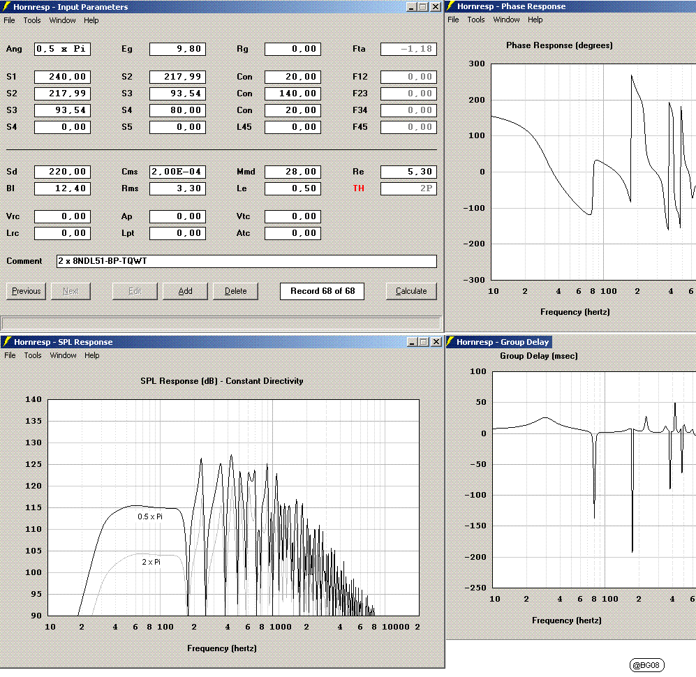

IMO, I fully agree with Eva:
‘In a tapped horn the phase varies wildly across the passband and above.’
See the bad phase response in picture: 2(7)

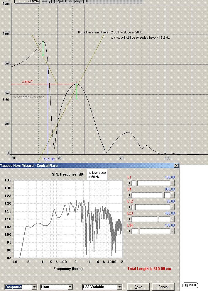

It runs out of xmax at only 12 V rms
No, earlier and even if you intend to use this design with most ordinary commercial bass-amps that often uses a 12 dB HP filters at 20 Hz for subsonic frequency protection. See picture 1(7)

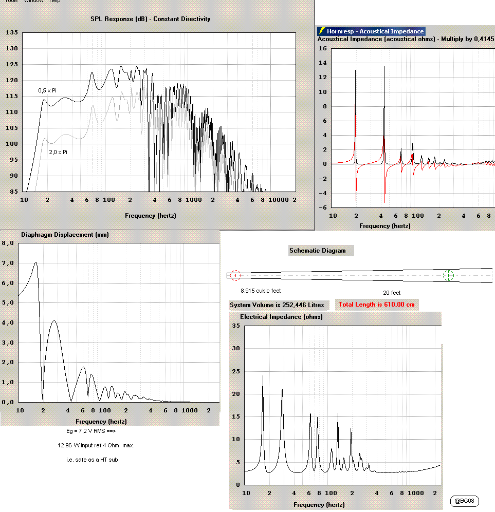

This should give around 118 dB max with corner placement.
Yes, but only if you count the SPL above 60-70 Hz Hz. See picture 3(7)

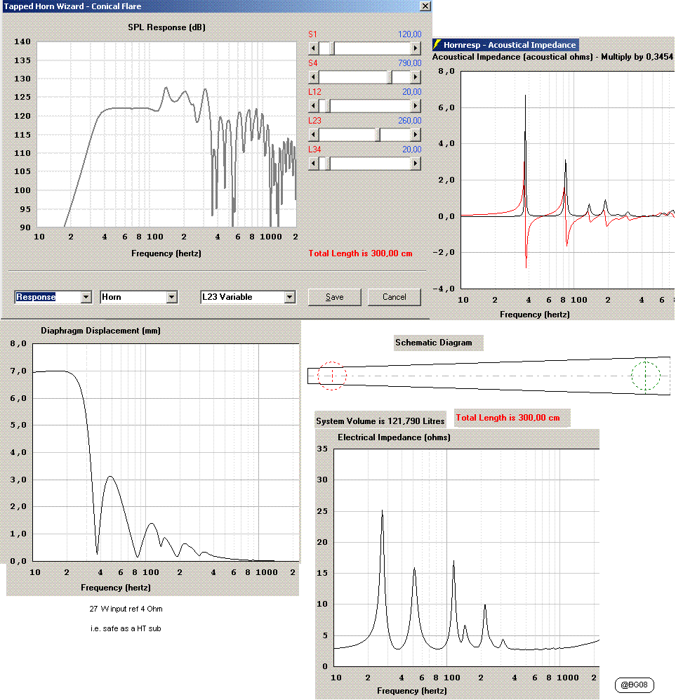

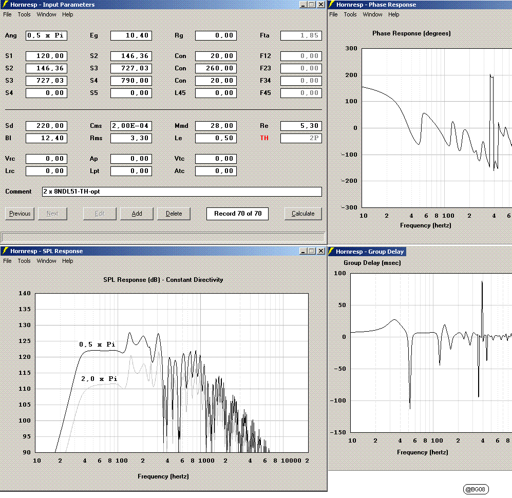

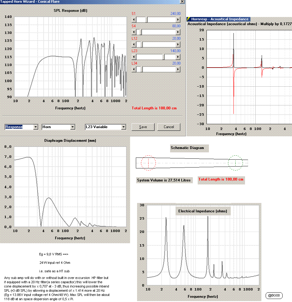

IMO a better use of the 8NDL51 drivers for Tapped Horns: See the pictures 4(7) – 5(7) and if SQ is the most important goal: See the smaller BP-TQWT in pictures 6(7)-7(7).

1(7)
