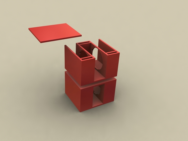

So how would WWW MTM W look aesthetically, baffle sitting on a box thats 2 woofers closest to the floor for the extra boost
Moondog55 said:If anyone has experience with other ways of doing this please let me know, I have been advised to use "H" frames for the woofers, WAF on those may be lower, but I have had a thought, lay a 2woofer H-frame on its side and then mount the plain baffle sitting on top, I could even use 3 woofers in the base "H-frame" yes it would be wide but perhaps I can fold it internally somehow, I have a dozen of these woofers to play with althoughi was going to use 4 of them or at least 2 in another project for friends,
I've decided on stacked W enclosures...not the most elegant, but the most efficient way of packaging 4 12" drivers.
I was investigating Ri-poles but my woofers don't seem to be the best in that set-up.
Pretty nice work BTW
Mine probably won't be Ripoles, and since I'm actively EQ'ing them, I have more freedom, I suppose. The loss of efficiency is the bigger problem with true Ripoles, IMO.
Moondog55 said:I have been advised to use "H" frames for the woofers, WAF on those may be lower, but I have had a thought, lay a 2woofer H-frame on its side and then mount the plain baffle sitting on top,
I dont understand, and it may be what you describe, but you could turn a tall H-frame 90 degree so that woofers are side-mounted , which means you could have any number of woofers making a line-array...it may give a different and problematic polar pattern, but who knows...it may work
Ofcourse it means that the woofers will have to be crossed low...dress it with speaker cloth, and your wife will be happy 😉
