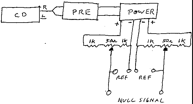

I've attached a GIF of a simple null setup that most DIY folks can easily try. Ideally, the 50 ohm pots should be multi-turn (trimpots are fine) so you can get an exact null but single-turn pots can also work.
A test CD with a pink noise track makes an ideal signal source. Pink noise is a dynamic signal that contains all frequencies in the audio band in roughly the same proportions as real music. You can, of course, also use real music and sine wave test tracks.
You simply hook a sensitive AC voltmeter across the null terminals, set a reference level at one of the reference points and then adjust the pots for the lowest voltage at the null terminals.
I put together the setup shown in the diagram and got the following null results:
Reference Level: 10 volts rms (after the divider network)
Null Level 100hz sine wave: 1.8mv (-75db)
Null Level 1khz sine wave: 2.0mv (-74db)
Null Level 20khz sine wave: 9.1mv (-61db)
Null Level 100hz square wave: 3.5mv (-69db)
Null Level Pink Noise: 9.8mv (-60db)
Null Level Music (peak hold): 8.1mv (-62db)
The above measurements compare the left and right channels of the preamp and power amp signal chains. Any deviation between them is at least 60db below the audio signal. As you can see, the channel match is over 10db worse at high frequencies--probably due to component tolerances in the feedback loop and board layout issues in the preamp and amp. NULL TESTING IS VERY SENSITIVE!
Now, just for fun, I swapped out ONE of the interconnects between the pre-amp and power amp. I used a cheap $2 RCA thin patch cord in one channel and a $140 KimberKable "Hero" in the other channel. I repeated the null measurements and they were all within 1db of the ones listed above.
When I have more time, I may try to perform a spectral analysis of the null signals with both cables. But just looking at the depth of the null, I'd have to say the cheap interconnect and the expensive Kimber interconnect are essentially equal and hence I doubt anyone would be able to hear a difference in a proper blind listening test.
In addition to testing cables, this setup can also be used to compare changes to an amp or preamp. You can change capacitors, resistors, etc., in one channel and compare the null results. If there's no significant change, it's a safe bet the change you made didn't make an audible difference.
Some things to be careful of... You ideally need a meter that's reasonably flat out to 20khz for the most accurate measurements. Many cheap DMMs are not. If you want to view the signal on a scope or perform a spectral analysis, be careful of grounding issues. The 1k resistors should prevent any amplifier damage if you ground one of the outputs, but you will get invalid measurements. Be careful of ground loops, etc.

Flawed Null Difference Testing
It is described in the Radiotron Designers Handbook too I think - late fifties.
Virtually ALL dmm's are NOT flat to 20kHz.
Also, virtually ANY amplifier will behave and measure perfectly into 2k ohms load impedenece, and your test setup is not duplicating real world conditions, except for line level gear.
The more correct method for power amplifiers is to use a Y-cable to feed both inputs, load both outputs with a loudspeaker (or simulated loudspeaker load), and then take a look at the amplifer output channel differences.
To find an arbitary null, a balance control shoud precede the amplifier inputs, instead of using a Y-lead.
Headphones across the amplifier output active terminals is useful for listening tests.
Different cables between the Y-lead and amplifier inputs ought to reveal more differences than your diagram.

Re: Flawed Null Difference Testing
My Fluke 189 is. As are many analog meters designed for audio use. Also, keep in mind, we're generally looking for RELATIVE differences here, so even if the meter is down a few db at 20khz if you're just comparing two nulls, it will still work just fine.mrfeedback said:Virtually ALL dmm's are NOT flat to 20kHz.
The particular example I outlined was for testing cables so you actually want the amplifier to measure better so that the null test is more sensitive to cable differences. Even with a 2k load, amplifiers are far from perfect where null testing is concerned. As I stated in the previous post, the two diagrams in the link are better suited for testing power amplifiers. You can also, of course, simply attach speakers and use the cable testing circuit as well.mrfeedback said:Also, virtually ANY amplifier will behave and measure perfectly into 2k ohms load impedenece, and your test setup is not duplicating real world conditions, except for line level gear.
Still Not Valid Testing.
My Fluke 77 is flat to about 500Hz.
Most cheap Asian DMM's are similarly bad.
Your own test results show worsening at high er frequencies.
Nope, you are still not testing under real world conditions, and your test will be less sensitive.
A lot of gear spits stuff back up the interconnect.
This is a big reason that interconnects can sound so different, and it gets worse with increasing load on the amplifier.
To be picking real differences the amplifier must be loaded as in actual useage.
This is to help you to be sure that you are making completely valid tests, in order to gain valid results.

Re: Still Not Valid Testing.
I'm also not aware of any way the load on an amplifier can "spit stuff back up the interconnect" or otherwise change the load at the input. If you have a technical explanation for that, I'd love to hear it.
But if you'd like, just hook up speakers and perform the same test. The cable test will actually be LESS sensitive that way, but suit yourself.
My own test results show a HIGHER null signal at high frequencies. If the meter was rolling off, it would record a LOWER voltage. You don't seem to understand what's going on here. The Fluke 189 is spec'd at 1.4db down at 100khz and it does considerably better in real life.mrfeedback said:My Fluke 77 is flat to about 500Hz.

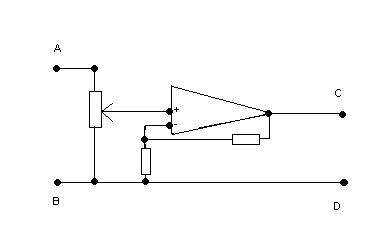

Tube_Dude ultimate null test...reprise...
To make more clear my null test i attach a schematic of it..
It can work with a signal generator or with a CD for real musical conditions of operation...and with a reactif load attached...
Connect a signal generator or a Compact Disc Player to points AB.
Connect your favorit loudspeaker to CD.
And connect to points AC :
-A DNM for to read the null
-A osciloscope for to see the null
-A second amplifier or a signal tracer fot to ear the null...
With the pot tourning from the minimum...you will find a point were the voltage between AC is at minimum...this is the null point!
It will show any type of distortion...because it will show the diference between input and output...and a zero diference will be the limit!!!
So easy and so real...
Your test results......
Hmmmmm, 100Hz-1.8mV, 1kHz - 2.0mV, 20kHz-9.1mV = rising error voltage/frequency despite DMM droop/frquency does it not ?.
So who is misunderstanding what ?.

In response to those against it, I hereby attach an appropriate image - I see no logical arguments, bad form guys.

I tried a different sort of null test last night on one one of my mosfet/LM317 choke loaded power amp follower thingies. I drove the input from a transformer so it was floating, then put the scope earth probe lead the live input and the scope probe live to the output. That means the only signal read was any difference between input and output. For a 24v p/p driving into 6 ohms resistive there was about 3mV difference just before the onset of clipping, but it was way down in the noise so it was a bit hard to tell accurately. Way better than just trying to compare input and output though.
The nulling...null...
Also in my test...the signal between AC is the difference between input and output...
But the first quot means that you are comparing the input and output.. as you are reading any diference...you are comparing...

I have no idea what you're trying to say. Your claim was DMM's don't have good response out to 20khz (which is certainly true of some of them). You pointed to my own results as "proof". Well my own results show a RISING null signal at higher frequencies. My only comment was that's not proof of anything as it's the opposite of what your comments would predict.mrfeedback said:Hmmmmm, 100Hz-1.8mV, 1kHz - 2.0mV, 20kHz-9.1mV = rising error voltage/frequency despite DMM droop/frquency does it not ?.
The above makes very little sense. First of all, your original comment was that the load on the OUTPUT of the amplifier affects what load the preamp/input cable sees. While load on the amp will change the feedback signal slightly, that will effect the other half of the diff pair very little even with a "psuedo" (resistive) current mirror. Then we have to consider that most of the input impedance is determined by the passive components in the input circuit which aren't affected AT ALL by loading on the amplifier. So you have a very small percentage (feedback), multiplied by another very small percentage (diff pair error), multiplied by another very small percentage (dominant effect of passive input components). The result, by any reasonable standard, is ZERO.mrfeedback said:In a conventional input diff-pair stage, if the current source is not perfect, and the transistor gains not linear, then a DYNAMICALLY varying input impedence will eventuate, and due to stored energy, stuff will spit back up the interconnect, and confuse the previous line output stage.
The input network to a typical power amplifier is a mostly resistive load with a small reactive component. This complex load DOES NOT vary in any significant way with loading on the output of the amplifier. If you want to convince me otherwise, show me the math.
