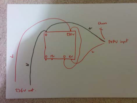

OK I have 248-9V mains, and I want to get that down to around 235V. I have a 50VA 240V - 2 x 12V transformer lying around idle.
I assume I can just use one of these 0-12V sections and create a 'buck' transformer to shave some volts of my high supply here?
My question is how to I wire this up please? I'd like to put it in a box with IEC connnectors so I can easily just plug my CD player (or whatever) into this bucking trannie, and then that into the mains.
Any diagrams for Mr mentally challenged here would be awsome 😉
- John
See attached.
The output you will get is closer to 236, but you get the idea.
If you use both 12V windings in parallel, you will end up with a VA capability of about 1000. That's the beauty of an autotransformer at the expense of lost isolation.
If there is any question about polarity of the windings, energize just the 240V winding with your 248V line voltage. Measure from the common point of the winding (bottom node) to the very top (dot end of the 12V winding). If you have greater than 250V, it is wired correctly.
edit: recommend a 4 or 5 amp fuse in both primary input legs

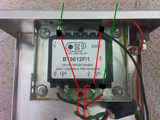

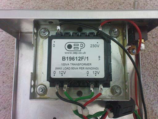

I'm still unsure how to wire this thing up properly/safely. Have attached a photo of the transformer in question.
A picture of how to wire this up would be grand - many thanks 🙂
P.S. please ignore existing wires - this is from a previous project.

Transformer is actually 100VA. If you only want to use one secondary, you will end up with a 50VA size. Connected as an auto, the size increases to 1000VA.
The black areas are to be soldered at the transformer lugs. Green wires are 248V input. Red wires are 236V output. You will have no issues running a CDP off this; the capability is 4 amps at 240V.
Leave the other 12V winding unconnected.
