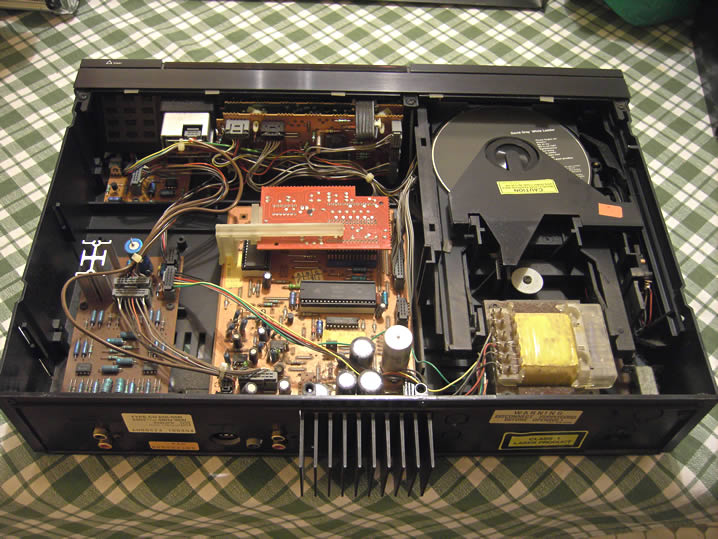

I popped the lid last night and had a look inside. In particular I noticed:
* TDA1541 PSU lines are decoupled by tiny 47u caps
* Op-amps are NE5532
* Op-amp psu caps are more of the same 47u Nichicon poop
* Signal goes through electrolytics and muting transistors
* The chassis is plastic

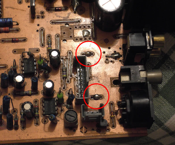

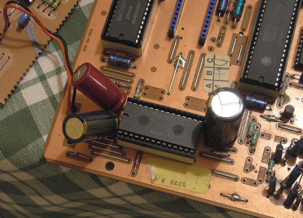

I warmed my iron, cleaned off some of the dust and had an initial tinker.
I made the following changes:
* -15V decoupling cap on DAC changed to 2200uF / 25V Panasonic FC
* -5V decoupling cap on DAC changed to 4700uF / 6V Pana FC
* +5V decoupling cap on DAC changed to 220uF / 35V Elna Cerafine
* DC blocking / signal caps cut out and shorted with a solder blob
This has livened the player up a lot. The bass is tighter, the treble less dirty and veiled, imaging is better and the soundstage is more layered. The good qualities of the player don't appear to have been adversely affected.

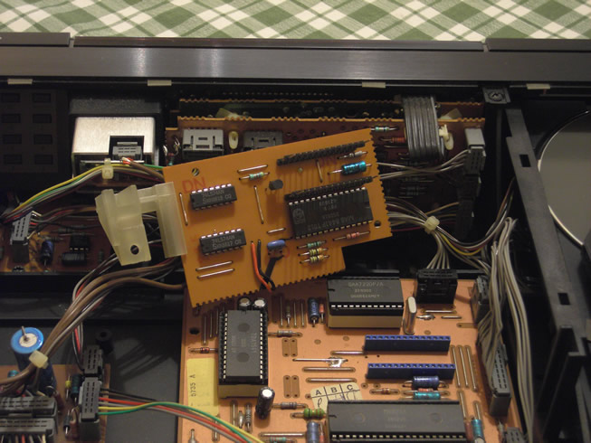

There are 650 versions with and without sub pcb for processor.
