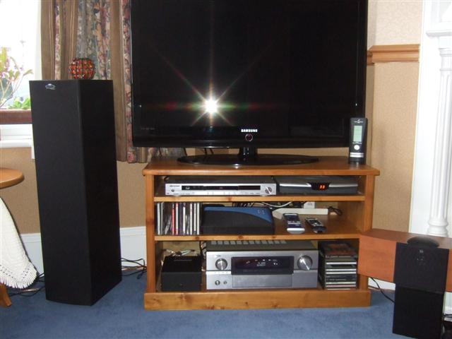

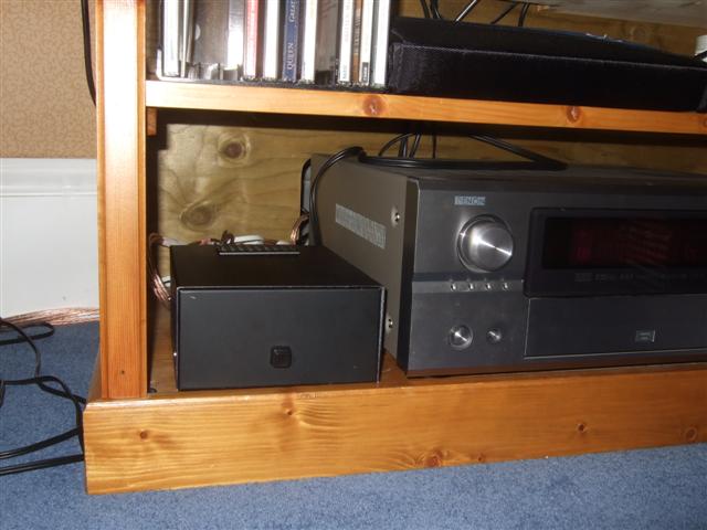

Though I have a fairly expensive amplifier a Denon AVR3805, which had good reports on its music capabilities, I was never truly and wholly satisfied with it when playing CDs. For AV it's fine.
Reading on this forum and others about how good these new D-Class amplifiers were, and particularly the Hypex, I thought I would give one a try.
It was particularly easily for me to add an extra amplifier as the Denon has preamp outputs.

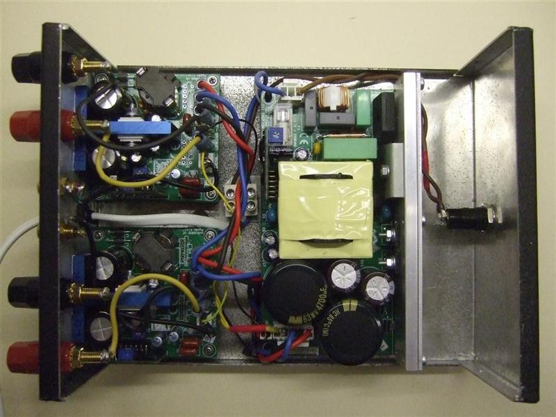

I purchased 2xUcd180 High-Grade amplifier modules and a SMPS180 powersupply, powering both models, from https://www.hypexshop.com/.
Bought the rest of the stuff, click on the List link below, from Maplin's http://www.maplin.co.uk/Home.aspx.

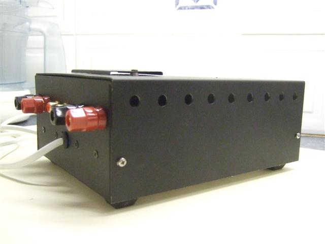

Construction was very easy and went ahead very quickly with a little help from members of this forum.
If anybody has any doubts about using the SMPS180 instead of the heavy bulky linear supplies let me assure you that the SMPS180 runs the two amps perfectly. One can turn the amplifier up to beyond the threshold of pain without any problems whatsoever.
Similarly, don't worry about having to use the Balanced Input Configuration, which doesn't have anything as far as I can see to do with quality of the music but just cuts out problems with hum when using very long leads.
I used normal RCA connectors with excellent results.

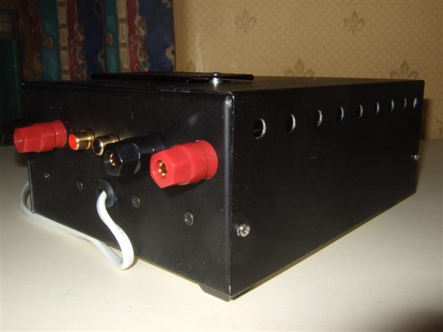

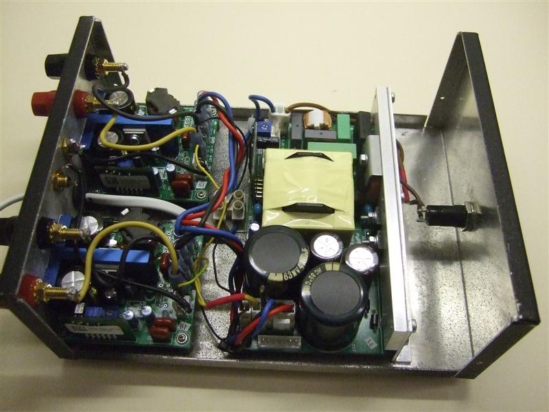

I cannot be sure but it looks from the photos like the mains power cord is only two core. If this is the case then there is no safety earth connection to the amplifier's chassis.
This and the previously mentioned lack of clearance between live parts of the PSU and 'safe' side wiring make using this amp potentially lethal.
Please be careful out there guys !
Rubbish, of course it is not dangerous. The metal case is connected to safety earth and if you had built an amplifier yourself one of the first things you would have discovered was that to prevent ground loops and mains hum, there must be only one straight connection to earth and all others via the RCA plugs shielded cable.
My Denon amplifier is the only unit which is earthed directly to mains.
Look at your CD player, I bet it's only got a two pin mains plug and it will, more than likely, have a metal case to.
The SMPS 180W is a Class 2 device..... :angel: ... no need for any earthing.....
