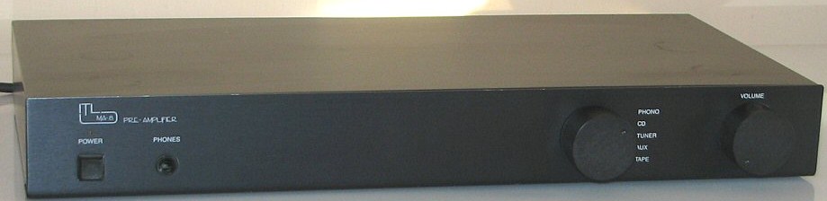

Malefoda said:Andy's pics about the origin of the B & W's Aura stuff:
An externally hosted image should be here but it was not working when we last tested it.An externally hosted image should be here but it was not working when we last tested it.An externally hosted image should be here but it was not working when we last tested it.
Cross threads...
