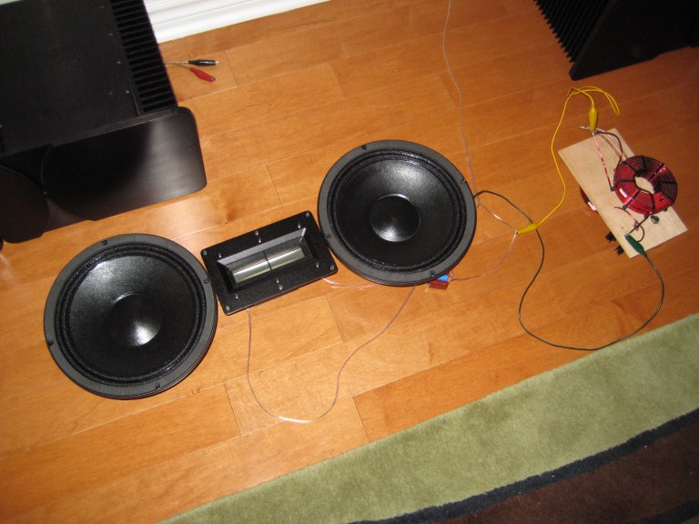

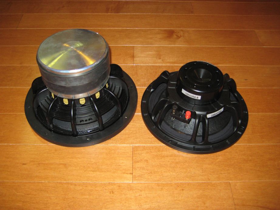

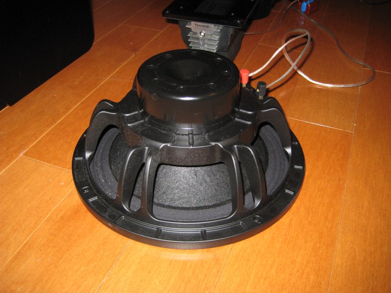

Hi Guys,
Just a quick update... the B&C 10" drivers arrived today, and initial impressions are very good!
I haven't had time to measure these yet, but that's what I'll be doing over the weekend. I have listened to them with a rudimentary crossover and I was very impressed. Looks like they're plenty efficient to keep up with the tweeter, so I think the finished efficiency will actually be 100dB if all goes well.
I have attached a picture of the drivers sitting on the floor, and one of the back side of the B&C driver.
They're quite well built, simple construction but excellent quality.
Owen

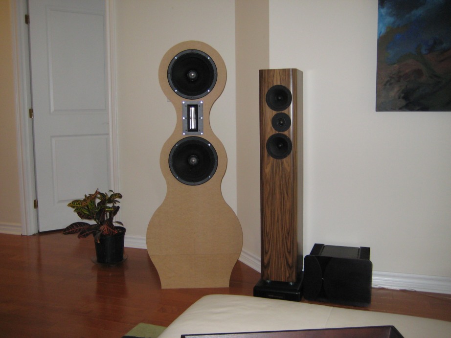

I have attached a picture of a mock baffle I made to give you an idea of where I want to go with these. It would be made with a horizontal "Trans Lam" process where I'd layer 30 pieces of 3/4" Baltic Birch ply to get that shape all the way back. I'd also round over the entire from and back perimeter with a 1.25" radius.
The general shape still needs some work, but it'll be something similar to that. I think it'll be good for reducing diffraction, and hopefully it'll look a little more interesting than the usual square box. I'm still debating between using MDF and an automotive paint finish, or Baltic Birch with a natural finish
I'll welcome any thoughts or suggestions, and hopefully I'll have some measurements to post tonight.

Here's a quick shot of the AE TD10M next to the B&C. The AE driver dwarfs it to the point that you'd swear it was an 8" beside a 10", but they're both 10" drivers with nearly the same Sd.
Both will be going in the test baffle shortly. It's pretty daunting pulling all this stuff out of storage, what I wouldn't give for a dedicated lab where I could leave all my speaker stuff.
Owen
Owen
And the back... this is why I love Neodymium magnets. With both AE drivers and the NeoPro mounted in that baffle, I can hardly lift it. The B&C weighs 8lbs, the AE weighs 22lbs, both have the same BL value.
Another interesting thing I noticed while breaking in both drivers was a whooshing sound made by the B&C woofer at high excursion. I break the drivers in by playing a near full excursion 5Hz tone for 24 hours, and that's when I noticed it. The magnet has some sort of cooling system that forces air over the coil and out those holes on the back. When the driver moves enough, you can really hear it rushing through the holes. Not a good thing.
Good stuff, keep it coming! Near and far responses of both would be very appreciated! Also try running an impedance sweep with the cone pushed in/out to about xmax, maybe 5mm or so for both. This is a very rough gauge of the motor linearity.
I don't know if I agree that the noise on the B&C is a terrible thing. If it's in a closed box-or even OB crossed high enough-you won't hear it, but what you will gain is arguably better power handling due to better motor cooling.
Strange bump in the impedance. Do you have another to test? How was the driver mounted when you did this test? Hopefully no sitting flat on a table with the vents covered up...
opc said:Another interesting thing I noticed while breaking in both drivers was a whooshing sound made by the B&C woofer at high excursion. I break the drivers in by playing a near full excursion 5Hz tone for 24 hours, and that's when I noticed it. The magnet has some sort of cooling system that forces air over the coil and out those holes on the back. When the driver moves enough, you can really hear it rushing through the holes. Not a good thing.
I noticed this on the B&C 12 TBX100 doing exactly the same thing as you. Its a non issue IMO since I never heard a thing once I got it in a cabinet. I tanned that thing as well.
BTW Neopro 5i has rising distortion below 2Khz with a large peak at around 1.6Khz. So be conscious about where and how you XO. The RAAL measures better than Neopro5i in distortion at same levels regardless of sensitivity. I don't use it below 2.5Khz 2nd order. You might find you come to a similar conclusion. Despite these ribbons having lots of radiating area, they are behind domes for distortion at lower SPL but from measurements, RAAL handles 113dB @ 2m with only 2% THD using 2.5Khz 2nd order LR filter which a dome couldn't do.
