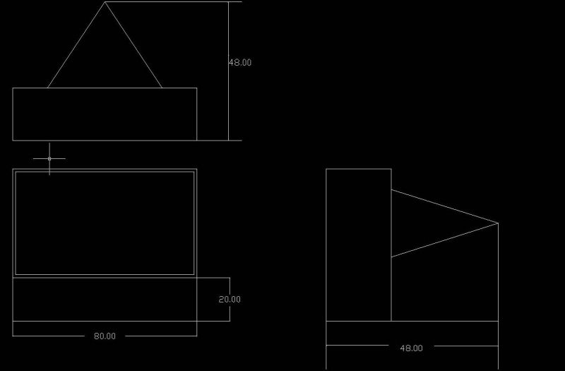

Well lets start with the easy stuff first
-We can make the outside of the tv(the box) out of MDF. Stuff is both easy and cheap to make and work with.
-Add some casters to it like the do on the floor
-I saw once at a show a piece of glass that had a projector behind it. Had a awesome picture to it(was playing games) but it was directly behind it and the pic was only about 37in while the projector was a good 7ft away. This means that we are gonna have to figure out some sort of mirror system to this. What I know we are gonna have to do is have a mirror at the back of the tv and it should be placed at the midway of the screen. The projector is gonna need to be at the bottom.
-The optics thing is gonna be a little challenging for me as I don't have my college physics book. You want X size diagnol screen your gonna need Y size mirror and the projector is gonna have to sit z distance away from it
Basically we would use a OHP at the back of the TV to project the image, the problem that I have ran into is the optics though.
Sigh I am dead tired rite now and will get to this explaining more of this tomorrow, hope the ACAD image shows up

ok guys now that I am a little less tired here is some of the things that I have though about.
Box construction would need to be plywood as MDF would be way to heavy.
The overall depth of this would be almost twice the depth of the current RPTV witch are constrained to 29 inches so this thing would be have to build in two parts at the current configuration.
I was thinking of building the projector using alans plans

I have though about using a acryllic or just straigt plexi glass for the image to be projected on. I have noticed that the plastic screen is a soft plastic and easily bendable.
The advantage of the RPTV is that we allready have a dark room but as the light will be enclosed in it by the box. I am also leaning towards the LCD over the CRT design as I really don't want to spend $4k on a RPTV to have it suffer from burn in. I also will be able to control everything VIA my HTPC.

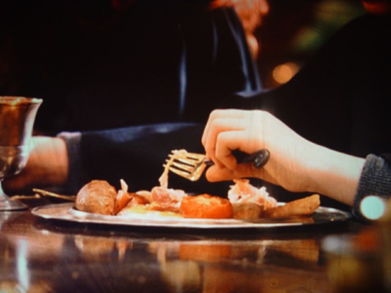

Thats a nice pic! What bulb you useing? Anyhow keep in mind that if you do increase the distance from projector to front screen it will also increase the light decay rate and be dimmer. This is a big advantage of the rear projection as it has a extreemly short throw distance the lumens stay high. Also by being in a box its not as effected by ambient lighting. Though of cource it will dimm aswell with lights on. My buddys 5' (I think?) rear projection RCA tv is dimm if you dont pull the curtains and dimm the lights. During the day you have to be RIGHT in front of it. 30o to either side and you get extreeme color washout. The rear pj also limits the viewing angle on most manufac. screens so as to increase the forward brghtness like BEF film does.
If you bring the image back down with a condesor it will also loose some light due to reflection-refraction and absorbtion of the lens. Another factor is that light at harsh angles like your short throw lens will not wanna be rebent by the condensor too well.

After messing around with both front & rear I've come to the following conclusion
Front projection is way brighter!
Was using rear proj screen from Dazian- does real well in eliminating hotspot- but still loses alot of lumens.
When you go with a more translucent screen for more light-you get hotspot city.
I've concluded that you need a screen like a real RPTV to do rear proj. (fresnel-lenticular big$$$$$)
BTW- my Phillips 50" RPTV- HDTV monitor is VERY bright even in daytime viewing- your friends set must be way outdated!
