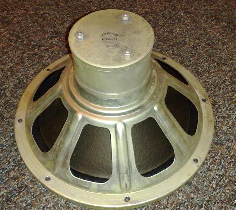

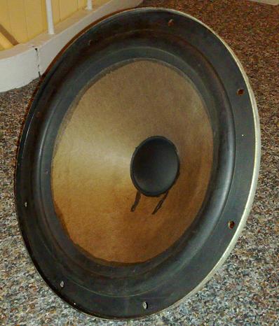

Ad1256/w8
Hi GM !
thank you for your reply.
The drivers I'm talking about are the AD1256/W8
These were done in a time T/S parameters didn't exist.
although it's widely believed these drivers have an Fs of 20Hz.
Which, understandable, makes them wanted (at least here in Holland)
Still I needed the other T/S parameters so I measured them,
and this is what I got:
driver one:
Fs 31.8 Hz (39ohms)
Qms 4.38
Qes 1.09
Qts 0.87
Vas 164,66 liters
driver two:
Fs 28,4 Hz (46ohms)
Qms 4.14
Qes 0.82
Qts 0.68
Vas 197.57 liters
Is this deviation common or is it a sign these babies were once spanked too hard ?
I only got them last week, so I don't know their history...
