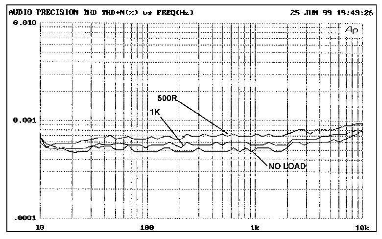

The only mod I can recommend is to use OPA627 if you want to build it and never open it again. Good luck with your project !
Jean-Paul
excellent op-amp...distortion virtually nil for typical loads and low gains (~3): see attached:
