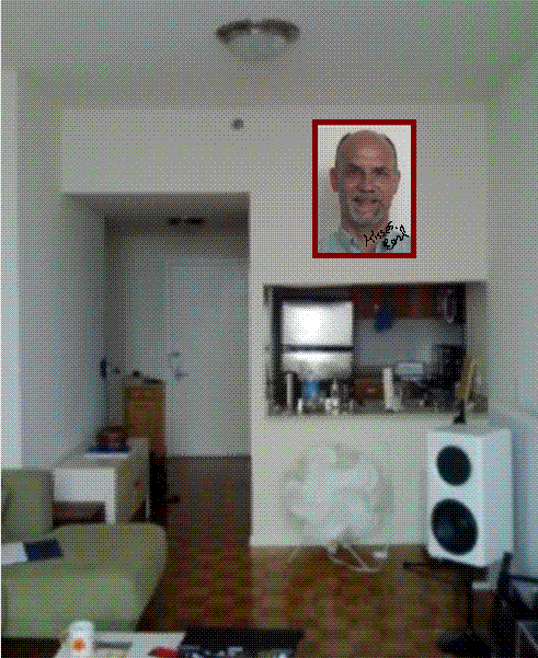

This is what my living room and the speaker setup looks like:
This setup has one big flaw: I'm sitting directly in front of the back wall which disrupts localization heavily. Hopefully a porous absorber will help.

Excellent start.
There isn't much that I can say about the setup, I can see that you options are quite limited. Sitting against the back wall is a very seriuos issue, but I don't see that you have many options. I might try using the legth of the room for the listening dimension, but with the furniture that you have shown this would be difficult. At some point you might want to try the longer dimension and see if it makes a big enough difference to make it considered as an option. Seems like you could move things arround temporarily just to give it a try.

If you haven't met your neighbors yet, I'd invite them over for drinks, and what not. Otherwise you could be introduced by them pounding on your common walls/floors. Then you’d have to change the names of the Nathan's famous to the "Mini Evictors"
As far as I understand Steve Deckert tries to "group" the reflections of one speaker on walls near that speaker. But when I look at this picture that might be true for the left speaker but where would be the reflections of the right speaker?
