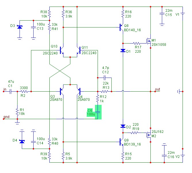

So this is what I've been playing around with for the last months, I think it might be ready for the vultures to tear it apart now ;-D hehe. I've been listening to it for some time now and I'm pleased with it.. sure it could be better with ccs and stuff but as usual, I'm using vicor modules with 4wire connection so, add it if you like, If I would, they would be something simple like a led and a resistor + bd139. And also I really want a low component count. Idle current is adjusted to 300mA or higher, hmm I've used somewhat lower too and It seems to work pretty ok at that too..
ps. add another couple of output transistors if you feel like it, but at 28v I'm not sure what it would be good for..

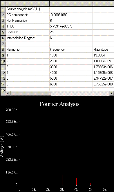

I know spice is not to be trusted very much but as comparison or just for fun, here is the fourier analysis in multisim10.. My old hp thd+n analyzer stops at 0.01% or something like that so thats not of much use here. so there is probably quite much space to add emitter resistor s here and there if you'd like.. hmm also a tip I got was the transistors zvn3310, zvp3310 and 06 transistors, but I hav'nt got around trying them yet.
Good work. The circuit begs to be converted into a balanced bridge design. Please explain the reason for hooking the junction of the 800ohm resistors to the emitters of the driver stage.
Jam
Jam
I guess it could be connected to the output ,tried that too and did'nt like it as much, then the 1k resistor was put there instead, at first it was like 33ohm and then 100 and 150 and so on , ended up with 1k . maybe 470ohm would be nice to. also, I guess I wanted a short loop there, not letting the output transistors disturb how the vas is working , letting that happen in the input stage alone. hmm maybe that's wrong I'm not a 100% sure.
Hmm the reason why I put that connection there in the first place was some vague idea that the vas transistors should see a similar voltage, hmm but that was at 03: o clock something at night so I'm not sure exacly what went on In my mind then..

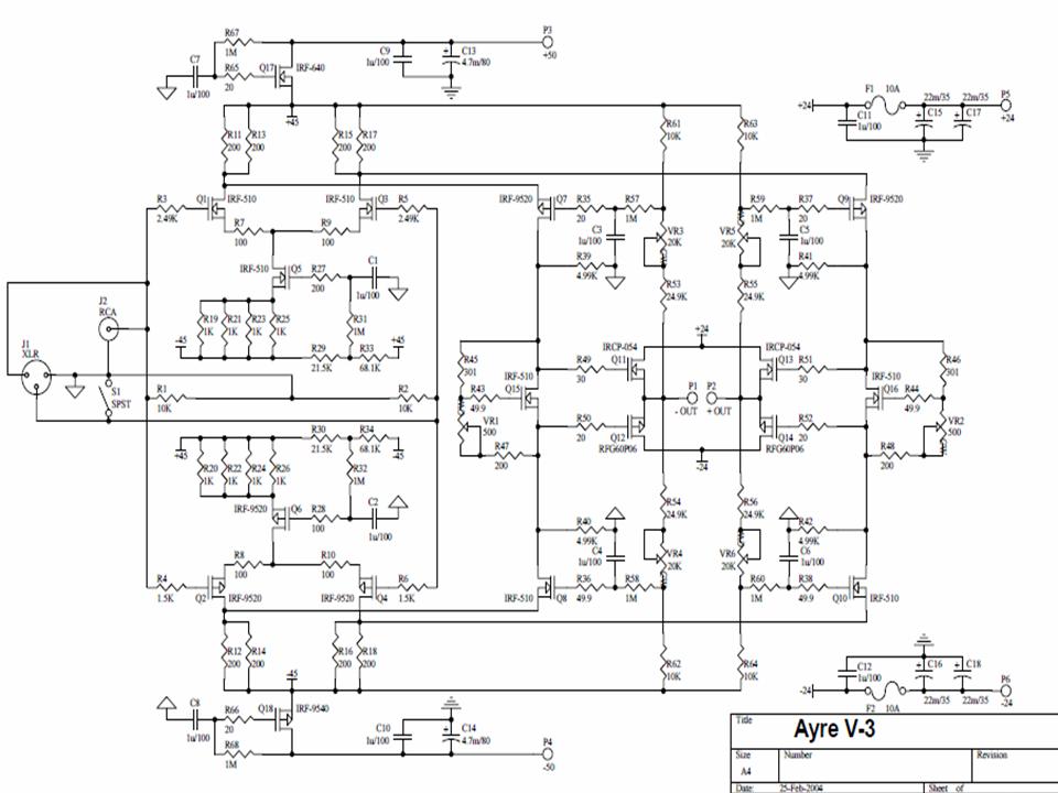

LineSource said:There are a few genius designers who believe that if an amp uses MOSFET outputs, then using only JFET and MOSFETS throughout the design can reduce the odd harmonic content, which they see as important for sweet, no fatigue sound.
You've probably studied the V3, but it might be of interest to other readers.

LineSource: Hmm good point, I'll have to study this closer. No did'nt see an ayre schematic before as I can remember hmm ,so no i've got something to look at in the bath today 🙂.

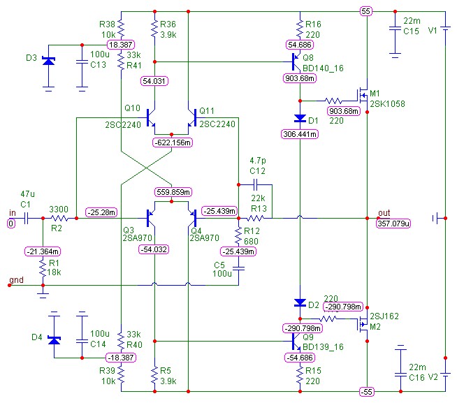

56K at the input and 18k NFB will create an off-set at the output. Make the input resistor the same as the NFB resistor.
Are we on Laterals now 🙂 Wondered why you wanted to get rid of the Vbe multiplier. The IRF's do however need thermal compensation.
The laterals are superb for audio - no doubt about that - but I would want to bias them a bit more accurately than using a two diode volt drop.
I dont think the unequal resistances seen by the input stage is a problem. The FET's draw no gate current.
Regards Karl

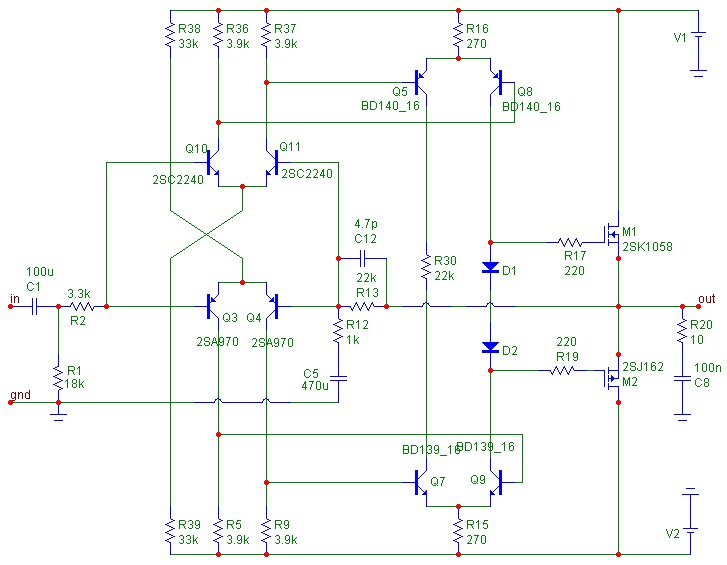

add another pair of output devices to the other side of the 2nd stage and get balanced operation.

Like transistors diodes have positive temperature coefficients.
you can omit the two driver transistors and vbe multiplier if you like, make it simpler.
Or just the drivers.. theyre really there just to Try to bump slewrate from high to stupidly high. I'm thinking of adding another transistor(of the other type) to the vbe multiplier and a resistor, it looks a bit lonely there. also then comes a nice source junction to feed somewhere or be fed ;-)..
even if the temperature works I'm sure one diode(per transistor) wont be enough for this gate voltage. also adjustment of quicent current will become somewhat strange.
Simpler still. The accumulative harmonic content is less than .00045% @ 50 watt, phase shift at 20 kHz only 1 degree. Bias is stable at about 250 mA at 27 deg centigrade and 228 mA at 50 deg centigrade.
Gain is 29 dB and perfectly flat to 800kHz, slew must be okay🙂
I will knock it together and see what it sounds like, probably not too shabby😕

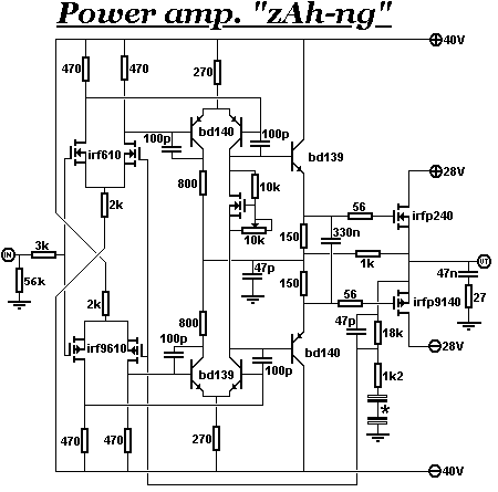

I think you should think about something better to set the bias of your output mos... The Vgs on of these devices is not really reliable. Other than that it's just the super classic amp topology... Look at this one from France, very good sound indeed, simple schematic but the cascode on the VAS is a nice addition

nikwal said:I know spice is not to be trusted very much but as comparison or just for fun, here is the fourier analysis in multisim10..
A brief tutorial on how to do this in MS-10? For those (me!) too lazy to read the manual, please.
I trust the THD figures that MS gives, as long as the models you use are good ones. I have verified the accuracy on one amp - if anything, the THD given by MS was higher than the actual amount.

MultiSim. How I make my FFT.
You setup your circuit.
With 1 kHz AC Voltage source input. With some level.
Then you right click on the net point where you want to do FFT.
Properties. Usual at the output.
Note down the Net Number of this point.
Analysis -> Fourier Analysis
You need to configure parameters.
Like freq (1kHz default). How many harmonics(default 9).
You need to click one tab, to specify output Net Number.
There is a list of all net nodes.
Now, you need to spicy output format.
I use Graph + Decibel scale.
After this you click down at the left: Run analysis
When you have big capacitors in your circuit,
you can sometimes need to delay the start of Analysis.
Until your capacitors are charged.
I usually run my FFT between Time: 0.8 - 1.0 seconds. (length = 0.2 sec with 5000 iterations)
This means circuit has got 0.8 sec initially to charge any electrolytic caps
and settle the voltages at different part of my circuit.
Good luck!
