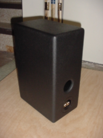

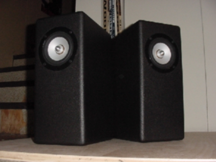

Sometime shortly after Christmas I put together these TangBand w4-657s full-range ported speakers. I am pretty impressed at how they turned out. With a little finishing advice from Al (RAW), I think they turned out pretty good looking.

could you explain a bit about the construction? mdf? 2 layers? did you use a router for the corners?
and what is the finish?

faustian bargin said:could you explain a bit about the construction? mdf? 2 layers? did you use a router for the corners?and what is the finish?
It's 1 layer of 3/4" mdf. About 14.5"tall x 6.25"wide x 9.5"deep (outside dimensions). About 8.1L tuned to around 62Hz. The terminal cup and driver are both countersunk. There is no internal bracing. The joints are sealed with caulking on the inside. All of the inside walls are lined with shag wool felt, which I bought for 99c at the fabric store. The port is 2" ABS piping which is sunk halfway(3/8") into the rear panel. The wood outside the portis rounded over to achieve a "mini-flare". And a 1/2" round-over with a router on all edges. The finish is "Al's Truck Bed Liner"(TM). It's the same as the finish on the ELF 1.5's from creativesound.com. It is such a great finish. It is easy to apply, cheap, fast-drying, and it looks quite professional.

So... Sound?
Well, they were intended to be used as computer speakers with no sub. So, I was willing to sacrifice a little flatness (just a bit) for some extra bass.
Another possible concern is that the T/S specs I used(from the datasheet) may not have been horribly accurate. I didn't have access to measuring equipment. (but I'm building my Wallin's jig now)
They are run full-range with no filter of any kind. The lack of tweeter causes them to sound not especially "bright". The lack of high frequencies(15k+ ?) isn't such a big deal considering the application. Everyone in my family, and my girlfriend, and my sister's boyfriend have listened to them and none of them noticed unless I pointed it out to them and/or A/B tested them with my other speakers.(keep in mind that they are not crazy sound freaks like all of you guys!) If I was going to use these as my main speakers, I would probably have used a tweeter. Since adding a tweeter and an XO didn't fit my design goals(easy/cheap), I passed.
So, that said, they do sound pretty damn good, especially for the well under $100can ($68usd) they cost me to build. They have a surprising amount of bass for such little guys. And, as per the design goal, they kick the pants off of any commercially available computer speakers. I am quite satisfied.

I used this stuff:
http://www.duplicolor.com/products/truckbed.html
Walmart. About $5usd for an aerosol can. You just spray it on.
