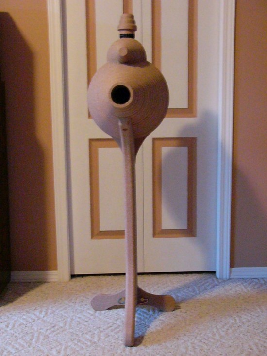

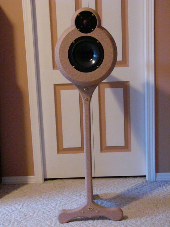

Here's something a little different. Lots of work but the final results I like. Haven't had enough time in listening to them to compare the sound to my regular ARdiys. I don't think the change in shape has altered the sound. I made these so I could use as ported or sealed. Will have to play with that.

I used 2 sheets of 3/4" MDF. This includes the stands. The stand center column is 2 thicknesses. The speaker wire is buried in this column. The larger cutouts can be used for the smaller circles.

Are you using them with a subwoofer and if so how do you cross them over (presumably thats why you have the plug for the port ?) ??

I haven't had a chance to give them a serious listen. But they do follow the specs of Ed Friases ARdiys (crossover, drivers , cab volume and port dimensions). I've built many of Ed's AR.diy speakers and find them to sound very good. I wanted to incorporate the port plug design to allow me try them sealed with my Tempest 15" sub. I will be working on a center channel design to fit with these speakers. A traditional MTM (on side) with a different look of course.
Hmmm, since you've significantly changed the baffle, don't you expect to need some crossover tweaking? Or did you do some modelling/guesstimating beforehand that compensated the narrower baffle with a more rearward vent?

wonder if one could incorporate this into a 2.5 way with one woofer firing backwards (push-push) and then build a TL into the stand?

I haven't had a chance to listen to them critically yet. But I suspect the new baffle design will not affect them negatively; probably enhance them postively. I think sometimes too much emphasis is put on computer modeling. But will see (hear) shortly.

my idea is to build 2 woofer cabinets and mount them one below the other with one facing the rear. any comments?
Hi Navin,
you better place them back to back in a single or sepereted chamber, but collect the magnets with some rigid wood. So your vibrations will compentate( and so do accelerating effects) and
you don´t have to care much about baffle correction as the woofer behind will simulate a big baffle and vice versa.

i know. i really like this design but too bad it cant be use for 2 woofers back to back.
on one hand i like the 2 woofer technique as it cancels out forces and provides for baffle step compensation.
on the other this system is so pretty. and also has its own advatages sort of like a tapered line and the B&W Nautillus effect.
