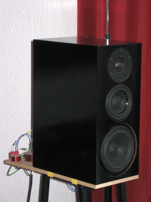

For several months I am working on a high performance monitor speaker for a commercial product. At the moment Scan Speak drivers are used throughout. After numerous iterations, I settled at a combination consisting of a 15W/4531G00 + 12M/4631G00 + D3004/660000 in a vented application.
I would like to go ahead and bring this project to an end, but there are major problems with the D3004/660000 tweeter.
One of the two tweeters supplied for our first experiments was faulty. Well, I thought it might be possible that we have damaged it by ourselves – but this was not the case. The dealer was nice enough to replace one unit – and after that everything was in good working order. No problems there after. Once again we sourced all new drivers because the test speakers were sold. Again one (only one) of the D3004 tweeters comes with the same problem that we encountered before.
The problem with these faulty tweeters is that they resonate mechanically and thus very audibly at input frequencies well above fres = 500Hz. A very small voltage level (less than 50mVrms) with a steady frequency in the range of 1200 – 3000 Hz is sufficient to trigger the resonance. Below the trigger voltage (trigger means, the effect does not come gradually, but abrupt) everything is absolutely normal. Above the trigger voltage, the driver impedance rises and the acoustic output is distorted or better say intermodulated.
Interestingly with music signals most of the time you won’t notice this resonance problem, because the signals are varying to quickly and some sort of steady level and frequency is needed. It is quite clear, that the audibility of this resonance effect depends largely on your filter order and the crossover frequency.
Since it is a mechanical problem, you can alter the “trigger point” simply by pressing the back cover gently.
Is there anybody out there, who knows about problems with these tweeters? Is it really bad luck, if 2 out of 4 units don’t work properly?
Tymphany is not willing to comment on this subject – which is a pity because otherwise the D3004/66000 is an excellent driver.

Are you certain that they do this right out of the box, or is it possible that they're damaged in use due to too gradual of a XO slope or excessive power? What is the crossover that you're using? Rough order, and XO point?
On the other hand, it sounds like a sympathetic vibration problem because you'd not expect pressure on the plate or sides to alter the dome behavior. While, of course you shouldn't have to do this would some damping compound pushed in around the gap between the magnet and front plate solve the problem? Model clay or Mortite for example. Might be worth an experiment.

I am pretty sure, that it is impossible that I have done something damaging to the D30s.
Last time the speaker came right out of the box, and they were
- mounted on a flat surface (no mechanical stress)
- soldered only one time and very cautious too (no overheating possible)
- no CLIO measurements without crossover attached
The crossover was 3rd order and 2000Hz and is now 2nd order and 4000Hz. The characteristic is basically (electrical) Butterworth, so no overshoots etc. Relative to the woofer the tweeter level is 6dB down now and was 9dB down in the older versions.
Since the design is a small monitor speaker and not a PA system, excessive power is not an issue here (moderate listening levels).
I could dissemble the unit and probably see what causes the trouble, but
- I want lose my warranty rights (return the unit to the distributor)
- I can’t do that if a couple of speakers are being manufactured
That’s what is driving me mad: should I drop a nice speaker design because of the reliability problems described or is it bad luck? I really don’t know.

The first box with D3004/660000 was from 2007, the actual ones are from 2008, production week 22 – I would call that brand new.
The SVS speaker company definitively uses this tweeter, but SVS is nearly unknown here in Europe. By that, it is hard to say if quality problems may exist. The Rockport’s locking very nice indeed, but as the faceplate is partly covered, you can’t say what they are actually using; it could even be a Vifa XT25 or an OEM version. Rockport hasn’t got a distributor in Germany for years, so it is the same as with SVS.
Another puzzling aspect of the D3004/660000 tweeters is that you can read here and there (see Rockport website too), that these drivers (or derivates) can operate at relatively low frequencies. Yes, it is a 1’’ soft dome, the resonance frequency is low and there is sound pressure in the 1000Hz region; but how does this sound? For me and the whole listening crew it sounded awful, if these drivers had to work to hard. Relieved from larger excursions (XO>2.5 kHz) I would say that these drivers live up to their potential.
The prototypes are almost finished, normally I would not change a thing; but if the mystery can’t be solved the R2907/700000 would be the replacement. Henrik, any comments on that? (Except for an even higher price tag)

Hi, thanks again for your input.
According to what I can read here, I would conclude that it is no longer a mystery. My personal decision will be, not to go on with the D3004’s. It is a good performing high end driver – no question about that – but such a delicate product needs support from the manufacturer.
1) Shaun
You are possible right, but a high quality driver should be consistent. From my personal experience I would say that Scan Speak drivers are usually very consistent in their parameters. My listening crew and I just disagree with the statement, that low resonance tweeters can automatically be used in the lower frequency range.
2) iseeall
Lovely to hear your report. Please bear in mind that the problem is there all the time (even if it is not getting dominant). A damaged D3004 is not nearly reaching its optimum performance level. Take care, that your replacement tweeters are matching those which are working properly.
