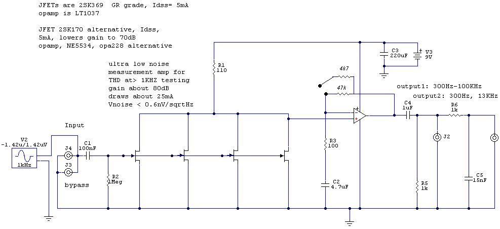

A fellow member of DIYaudio.com requested the schematic of a very low noise preamp I made. I made it a year ago, maybe more, to measure harmonics, after a -100dB notch filter. Feeding this to my sound card enabled me to measure THD down to -140dB.
Here goes, any comments?

DIY offcourse!
I never really reached -140db, but close, somewhere around -130dB... again using a passive parrallel-T notch filter to filter out the 2nd and 3rd harmonic. I routinely reached -120dB but the last 10dB take some tweaking and patience...
The amplier does enable me to reach down to -140dB but I don't have a pure enough oscilator.. that explains my interest in the Uber-pure-oscilator (see Jackini) and ultra high feedback opamp in general...
jackini are you reading this? How about a super-opamp/LM3875 combo? Can we put togher a 180dB feedback chipamp?
Thx John!

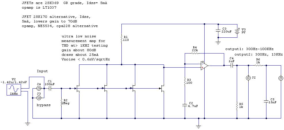

I actually spotted a mistake. I thought that I had two 47K in parrallel as feedback resistor, depicted as 22K in the schematic, but now I see it is actualy a 47k adn a 4k7 resistor that cab be sattached parrallel to it.
I measured gain yesterday, at 1KHz it's 7680x (47K fb), and about 700x (47K||4k7).
grtz,
Thijs
