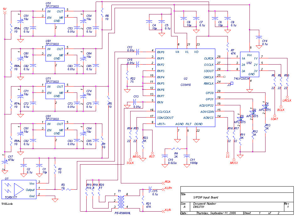

I'm looking to add a S/PDIF receiver to my blackfin DSP kit and I'm not finding anything that fits. There's some well designed S/PDIF DACs but that's more than I need. If anyone knows of a good quality module please let me know before I waste too many hours duplicating.
Anyway, I working up a CS8416 receiver into a 2" x 4" PCB that will plug onto the Blackfin EZKIT expansion bus. Essentially a fully featured S/PDIF input with an I2S bus programmable by SPI.
A few of my pet must-haves: individual regulators for every IC power pin. (If the chip designer bothered to give us multiple pins, we shouldn't tie them together) complete ground plane, controlled impedance connection for high speed buses with proper drive & termination, surface mount, consideration of EMI issues.
I'm going to build a small number for my own needs but would be willing to share if there's any interest in peer/design review. Quantity discount brings the PCB cost down.

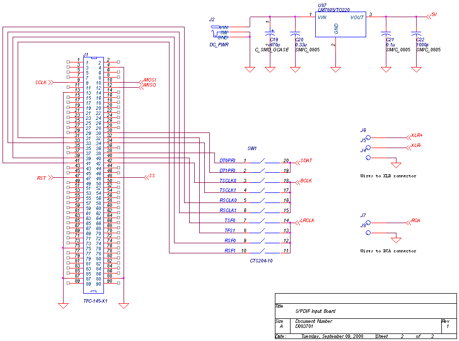

Sounds like a good idea. I don't have a huge need for a board like this, but I'll certainly throw a bit of help your way. What layout program are you using? If you're using Eagle, I've got part libraries for the Samtec headers and a couple example boards created which use the BF533 expansion headers.
A couple of suggestions:
- Add DIP switches which allow you to connect the CS8416 bit clock and FS outputs individually to the TSCLK0/TSCLK1/RSCLK0/RSCLK1 and TFS0/TFS1/RFS0/RFS1 signals.
- Perhaps even have DIP switches selecting whether the CS8416 drives DR0PRI or DR1PRI.
- Add a spot for a wire, so you can take RMCK from the CS8416 and bring it up to the EZKIT's main board and use it as the MCLK input for the AD1836 chip.
These changes will let you run the onboard codec synchronously with the CS8416's audio input source.
A couple of things I need to research unless anyone knows:
Do the GPO pins have enough drive to source 5mA for the LEDs? I see the logic level specs rated at ±3mA but there's no spec for current limits.
Spec says you can either float the unused S/PDIF lines or tie to ground. Has anyone seen any performance difference? Thoughts?
OK to float OMCLK?
Anyway, thanks gmarsh for some good comments. Oh and BTW, I'm using Orcad.
OK to float OMCLK?

On the schematic...
The way you've got the AES/EBU input set up, the input signal level can't be greater than 3.3Vpp. Most AES/EBU sources I've seen are 5Vpp square wave (loaded with 110 ohms) and bandwidth limiting pushes the edges up higher than that, to 6-7Vpp. You'll want to divide that down or you might pop the '8416.
I've never encountered any disconnected-input-weirdness problems with a CS8416, though I've never actually designed anything where the input wasn't directly fed into a SRC chip.
If you want to move away from the '8416, I recently used the DIX4192 transceiver from TI and I can't say anything bad about it. It has four real, actual differential inputs. And a transmitter (heh). It does require a +1.8V supply, but in your application I don't think that's a problem 😀
more good stuff.
So a Pi network on the front end should provide infinite balanced adjustability. I'm going optical so I hadn't thoroughly flushed out the transformer input. I set it for just over 13dB attenuation (seeing as you get 6dB for an impedance matched connection) with standard resistors.
Talking of impedance matched - what do you think about 192KS/s (6MB/s+) through a DIP switch - not exactly impedance controlled. Is this a jitter nightmare about to happen or is 6MHz sufficiently slow?
Anyone else had lock problems with the CS8416? Any votes to abort?
You could use 74**125 chips with the outputs enabled/disabled by DIP switches, instead of dip switches directly - however, the additive jitter of the gate would probably be more than anything caused by an impedance mismatch through a DIP switch.
The SMT slide types like those on the EZKIT itself are pretty low inductance. IIRC, the EZKIT actually runs a couple of memory interface signals through DIP switches..

I axed the DIP switches and substituted a zero ohm matrix - less space, less cost and made me feel better about high speed data through complex mechanical parts.
The spare I2S port is brought out to a 2x4 pin header for future expansion.
The transformers are 2:1 center tapped which provides a 6dB attenuation option on receive (selected by C9/C10) or 6dB boost on Tx (assuming the SRC4392 can drive 38ohms.)
So the schematic looks like this:
schematic page 1
power supply
expansion connector

Comments on design:
The TX+,TX- lines running under the chip, necking down to 6mil and running through the receiver circuits have to be the worst aspect of this layout. This act denies the possibility of top side ground plane under the SRC chip and routing the substrate connection BGND directly to AGND as the datasheet recommends for minimum jitter on RX stream. I did this because I wanted all connectors PCB mounted on the same board edge on smallest board area and I’m relying on the ASRC to solve my jitter issues.
The RF treatment of the S/PDIF RX and TX is suboptimal. Ideally you would use 75ohm microstripline to route the input and output sections but that requires trace widths of 50-60mil on 62mil FR4. The 10mil traces used have an impedance closer to 130ohms. Also the stubs connecting to the BNC connector will no doubt provide a reflection. I could cut off the offending traces if I was concerned. The traces aren’t length matched, this means a slightly different time-of-flight for +ve and –ve traces. The SRC4392 has an input impedance of about 25K on its input-comparator-with-hysteresis which probably needs another pi network impedance transform. That’s three strikes I know but I’m gamboling that the ASRC saves my BE.
2:1 transformers are frowned upon. I see it as an interesting gain management opportunity so I want to try this out myself; but the bottom line is there are 1:1 transformers available in the same package that can be configured on the board as it is.
The AES Tx output trace to the optical transmitter has no impedance management and runs pretty rampant around the input sections. I fear this will be a jitter/locking problem when re-transmitting but for my own application, I intend to turn this feature off. I can explore this if anyone’s interested.
This is a prototype for my own edification and so is not intended to be perfect, just useful enough to collect some data and learn.
I also intend to do a lot of experimentation on the power supply. Some of the LED’s and steady state pull ups are pulled to sensitive supplies such as the optical and analog supplies. These can be isolated if needed, it just made the layout cleaner. I want to see what advantage the 60dB PSRR of the individual TPS regulators has over a single universal supply with inductor-capacitor filters for individual loads. This will have to be performed with flying leads and tombstone inductors – but I think if I can keep the wires on the PCB surface it’ll be good enough.
