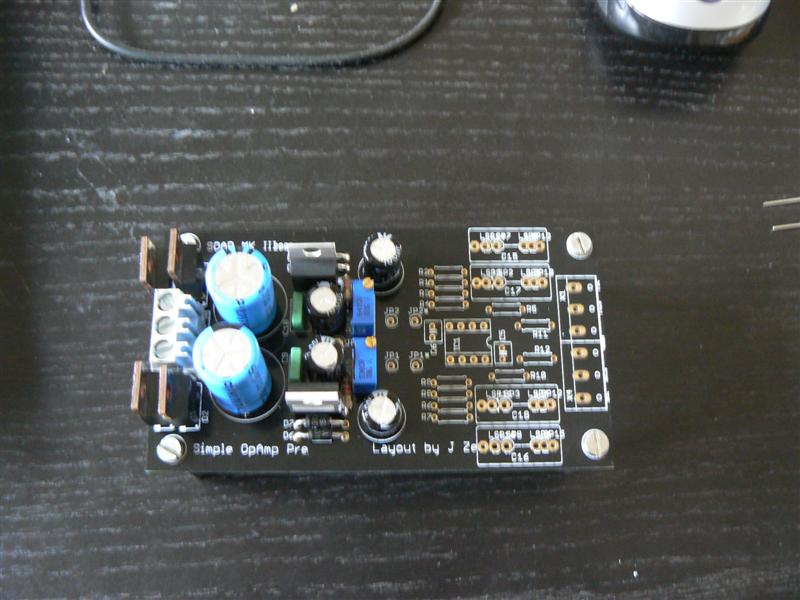

So. The friend posted me a PCB for one of the projects, a OP-based Preamp designaded SOAP (Simple OpAmp Pre) and I put it in one of my drawers since I didn't feel like building anything. But I got fed up with chasing humm so I checked my partsbin and saw that I had all components needed for the SOAP and last night I started out by just soldering some resistors in place. One thing led to another and this morning all components where placed and soldered. Some parts where missing but the could be found in the pre I was using at the moment. So I decided to remove it and place the SOAP there instead and do some light testing. And thats where I am now.

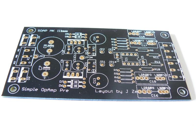

I guess that I should post some pictures now that I have rambled on for this long. Here is one of the plain board, it measures approx 50x100mm (thats roughly 2x4 inch)

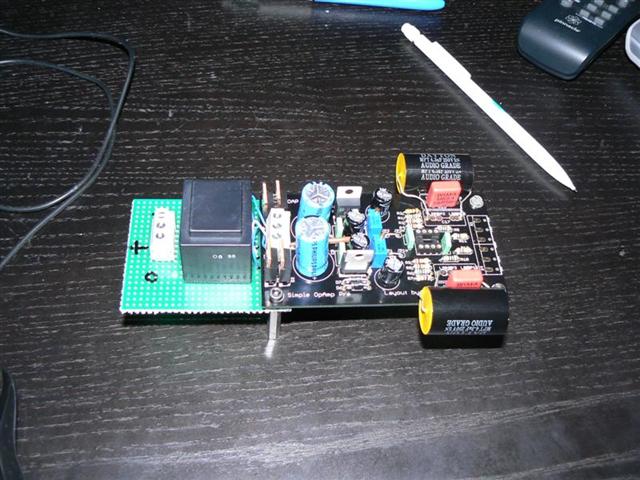

I wanted to have a transformer placed on the board but since it didn't come with that possibility I sawed out a piece of board, soldered the transformer and a fuseholder to it and screwed it to the SOAP-board. The result isn't that esteticly pleasing but it works for me. I placed a pair of cylidrical caps on the output but didn't like the way it looked so I later removed them (black-yellow in the picture).

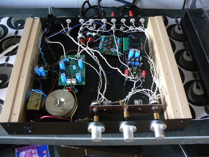

So, then I placed it in the casing and this is how it looks now. At the start I planned to have tre different transformers at one place and due to the larger BOZ that was the only way. Now with this smaller pre-amp I will move some things around and shorten a lot of wires.

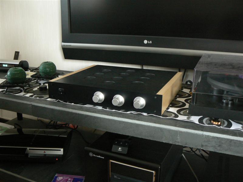

kmj said:last one with lid on.
Hi Kmj
I like your case...
If you didn't make the case yourself, may I ask where you purchased it?
Richard
