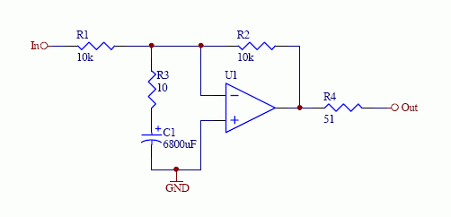

Did anyone notice the unbiased and unbypassed 6800uF caps in the test circuits?
Unbiased, do you mean the + of the 6800uF should be more positive than the - of the 6800uF? How can we do it in a simple cct?
