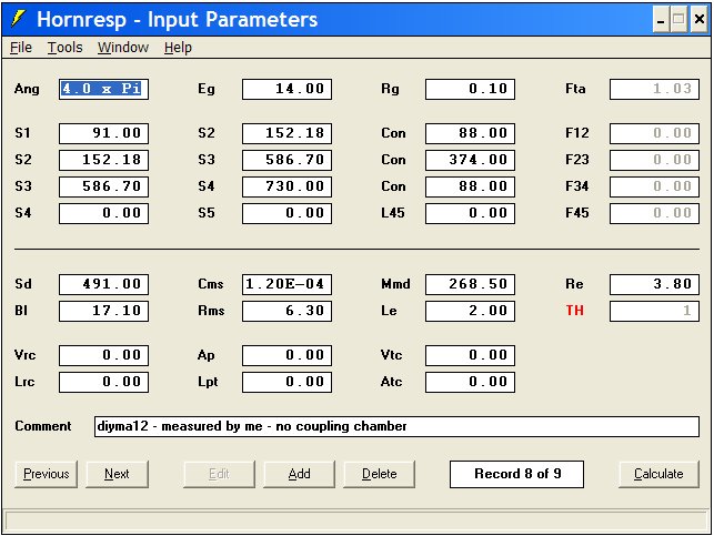

Here's the thiele small of the Diyma, which I measured personally after breaking in the driver:

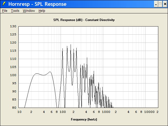

Attached is a pic of the response, using the parameters from the previous post. It's getting 50watts in this sim.

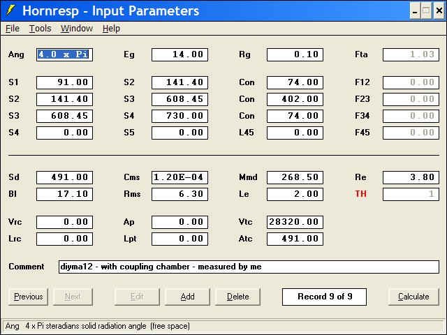

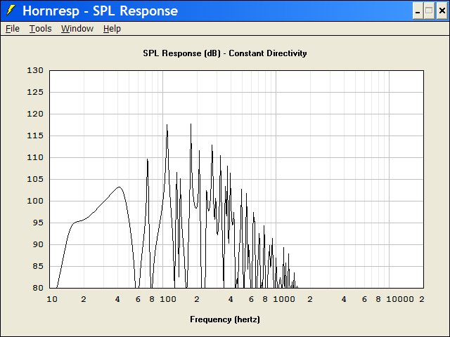

Here's where it gets fun. I take the exact same sub driver, in the same tapped horn, and add a coupling chamber. I also tweak the driver location using the tapped horn wizard. The overall volume is nearly the same, except the coupling chamber takes up a cubic foot. (That's the 28320cc in the VTC column)
Here's the frequency response WITH a coupling chamber. First thing you'll notice is that it's dramatically tilted down. I actually did this on purpose. I haven't seen anyone put a tapped horn in a car, and the Diyma 12 is a good candidate. In a car you *want* the response to droop, as the car's cabin gain adds about 24db at 20hz, and 12db at 40hz. That's why small sealed subs sound so good in a car, and big vented boxes sound sluggish and boomy. The car's cabin gain ruins the flat response of a vented box, and augments the slowly decaying response of a sealed box.
But this tapped horn gives you the best of both worlds - the low excursion of a tapped horn, combined with a driver that can take some real abuse.
Once you add in cabin gain, the F3 of this monster will be around 15hz! And the power handling, thanks to the low excursion, will be downright absurd.
It could use a little tweaking, with a bit of work someone could easily make this fit in a smaller box, with even HIGHER power handling. You don't really NEED an F3 of 15hz in a car do you? Have fun!

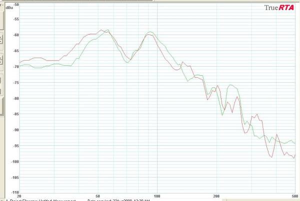

Hi Patrick,
I've been doing a fair bit of measuring over the last couple months as I'm in the middle of installing my stereos in my commuter hatchback and my weekend suv. In both vehicles a sealed box does not measure like the car audio sites would have us believe.
Rob.
RobWells said:
Hi Patrick,

Andy Wehmeyer over at JBL posted some cabin gain measurements that his company did. Based on JBL's data, it looks like my numbers were off, but not by much. JBL shows about 15db extra output at 40hz, and 25db at 20hz. Here's the pic:
RobWells said:That doesn't mention my commuter car - here's a plot of the 'xt10' sub mentioned in that thread in this small hatchback.
That's pretty consistent with JBL's data. The notch in your car is at 60hz, instead of 70, and there's clearly tons of cabin gain kicking in at 50hz.
Funnily enough my infinitys are part of jbl's parent company (Harman int) and their data sheet shows much the same plot as that you just posted. (as does the data sheet on my JBL gt4'S that are going in the hatchback)
I suggest you measure for yourself to get a 'real world' measurement as they just aren't so pretty.

I'd say it isn't consistent at all with jbl's data - they show a general rise in spl below 50Hz, whereas my graph is dropping below 50Hz.
Rob.
The only thing I can possibly think that explains the difference could be that both my vehicles are fairly old ('93 and '96) so probably not as 'gas tight' as the vehicles measured by JBL. Maybe if I spent a fortune on new door and boot (trunk) seals all round I'd get more boost in the lowest bass.
