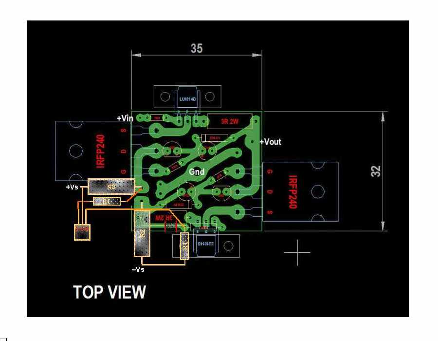

I attach the layout in scale 1:1 (almost real size) .. in my 17" monitor
You have unfortunately posted the wrong layout. This is the old layout of the DAO follower without the Taylor CS. The one in the Power Point includes add-on components to turn the old layout into one with Taylor.
I hope you can delete this one to avoid confusion, or at least post the proper one with the 2SJ103 and R1 to R4. I tried to save the Power Point as JPEG but it gave very poor resolution, which was why I zipped instead.
just used you latest ZIP
if you have the wrong layout in the ZIPPED powerpoint
it is nothing i can do about it .. is there?

> if you have the wrong layout in the ZIPPED powerpoint it is nothing i can do about it .. is there?
Just to be sure it wasn't my mistake, I downloaded the zip file from the forum just now, opened it, made it full screen, and printed that into a jpeg (sorry for the poor resolution).
And this is how it should look (see especially bottom left corner) !!!
Nothing wrong with the ZIPPED powerpoint as far as I can tell, probably something with your computer ? Or you are using some Windows Office equivalents ?
