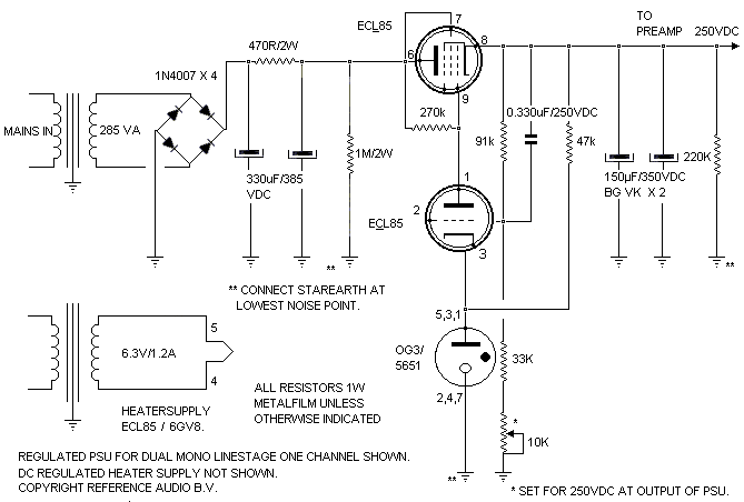

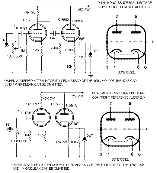

I found this design from a google search that got some good feedback, and I want to build it because I have been looking for a good 6sn7 preamp. I also found a power supply, but it seems like the transformer has an odd VAC, and the regulator s a bit complex and out of my tight, tight budget. Is there a good 250v B+ design that uses either SS or tube rec. and uses a common transformer voltage? Any help would be greatly appreciated.

That's Frank de Grove's design, a very solid one. I'd probably update the supply a bit (high speed diodes are cheap these days), but if you build it as-is, you'll have a fine performer.
That looks nice, but pardon my noobness: what is the symbol at the end of the circuit?

ambience exists said:That looks nice, but pardon my noobness: what is the symbol at the end of the circuit?

The symbol at the end is my best guess at the current draw of the preamp.

Nice simple design on the preamp... note that it has an inverted output, so somewhere in your signal chain you need to invert polarity again. Most likely at the speaker side if your amplifier is non-inverting.
On the tube regulated supply... also nice and simple, but two notes:
1- the 5651 is a voltage reference tube, not a shunt regulator. Maximum current is recommended at 3.5ma and operating design point should be around 2.5ma. The design runs it beyond 3.5ma based on the 47K dropping resistor plus the current flowing thru the triode section... probably closer to 4ma total which will reduce tube life. A 68K would be better.
2- pretty much all gas regulator/reference tubes can oscillate so putting a small value cap in parallel with it usually alleviates the problem. Sylvania recommend a 0.02uF shunt capacitor, but a 0.01uF should be fine.
Happy building... post some pictures when completed.

SY said:No need for something that inelegant, you can use the Zener reference string to exactly set the output voltage.
Yeah, but how do you explain that to someone who is not an engineer? I'm not sure of what you mean.
I did measure the xformer, and I think the main winding is 430 volts. There are red wires. The other windings which I assumed were the filament windings and are green/brown/yellow/etc... are giving me strange, un-filament numbers, but I may not be measuring them correctly.
Really what I want to know is if I can use this xformer with that PCB kit to power franks preamp?

Standard plate/filament wire color codes are usually:
Black - Black = primary, 120 volts (for US)
Red - Red = Plate supply winding - Red-Yellow (trace) is the center-tap
Green - Green = 6.3VAC filament winding - Green-Yellow (trace) is the center-tap
Yellow - Yellow = 5.0VAC rectifier filament winding (usually no center-tap)
Any other colors could be additional filament windings or primary tap options. You should measure continuity/resistance of each winding and make yourself a schematic drawing. Some power transformers have a static shield which can be on a separate wire.
Also note that an unloaded power transformer will read high on voltages. You can safely assume the yellow pair is good for a minimum of 2 amperes as most rectifiers require 2 amperes... some big ones are 3 amperes. The 6.3VAC winding can vary anywhere from 2.0 amperes for something small to 4.0 or more for large iron. Plate windings vary greatly on voltage and current based on intended use.
Zener diodes are basically shunt regulators, ie, they have a specific junction voltage and maintain that over a current range. You could take five 47-volt zeners in series and be close to 250 volts with simple shunt regulation.

To follow on to KM's excellent post, the Zener string as shown has two 100V Zeners in series with an 80V Zener. If you use two 80s and a 100, you'll be at 260V (actually, 261.25V because of the regulator chip's 1.25V reference). That's close enough for this circuit without doing anything more.
