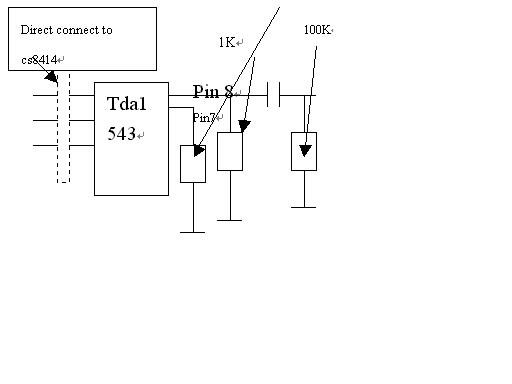

i want to ask some question about TDA1543.
is it only support I2S format?
i use a AD1892 to work with TDA1543, it dosnt work.
then i use CS8414, it work best in I2S mode. but the Analog output of the TDA1543 is too small(about 100mVp-p), and the wave have many high frequency in it.
(i use a 1K hz test CD to do the test.)
i use 1K resistor to connect pin 8 and 7 to GND, the supply voltage is 8V.
please help!

TDA1543 is I2S only and when CS8412 or CS8414 is used in the right mode ( 2 ) you should have an outputvoltage of at least 0.7 V. This is with 5 V supply and 3 x 1 k resistors. Try to lower your supply voltage to 6 V and see what happens. Not all TDA1543 like 8V. Tried it but it clipped severely.
BTW did you play the right track for measuring output level ?
Please see this site for correct setting of the I2S mode:
http://www.geocities.com/rjm003.geo/rjmaudio/diy_dac.html

Takashi.. you need to load pin 6 (left out) also with a 1k and drop your voltage to 5V if you want to use that value 1k for vref and IV. Vref needs both dac outputs loaded, otherwise it clips severely and is not at all usable. 8V supply requires slightly taller resistors.

Takashi, what are you doing :eek:
You either got a very strange TDA1543 or it is screwed up (can happen btw).
The Riv is way too large (4.7k) to stay within DC voltage compliance of the DAC.
Read the datasheet and you will understand.
You must limit the AC voltage swing to stay within 1.8V and Vsupply-1.2V.
In your case with Vsupply of 8V, your maximum swing is 1.8V to 6.8V, that is 5V.
With an assumed output current of 2.3mA, this results in a maximum Riv of 2k17 (5V/2.3mA).
You need a biascurrent of 0.828mA (1.8V/Riv), so Iref needs to be 0.414mA, resulting in a Rref of 5k31 (2.2V/Ibias/2)
I would advise to select Riv < 2k17 and to use a pot for the bias.
Adjust the pot such that with no music playing the output voltage on pin 6 and 8 is in the middle of your DC voltage compliance range, in your case (8V-1.2V-1.8V)/2 + 1.8V = 4.3V

i am so sorry, i am new in tda1543.
i find that 1k resistor is used, the sound clip and very loud noise.
then i use 3 variable resistor to tune the sound, i find that pin 7 use 2k, and pin8, 6 use 3-5K sound best.
i think i need to check one more time...
and one more question, what is the relationship between resistor of pin 7 and Ibias, and what is the relationship between Ibr/Ibl
and Ibias.
thanks
Says it all Takashi, just like the hard-to-read datasheet does.
