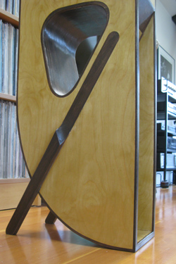

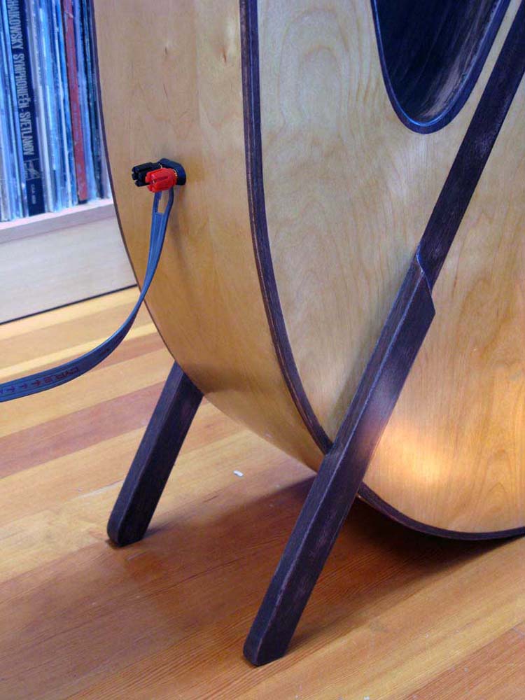

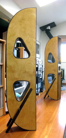

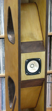

So, here I go again. I posted a couple of shots of my newly built Curvey Harveys on other threads (FR vs Studio monitors and VanIsle diyFEST) and there was some interest, so here are a few more. If anyone is interested, I will post some build photos and remarks as well.
I'll put the photos in separate posts, since I don't want to hassle with a web photo-hosting service.

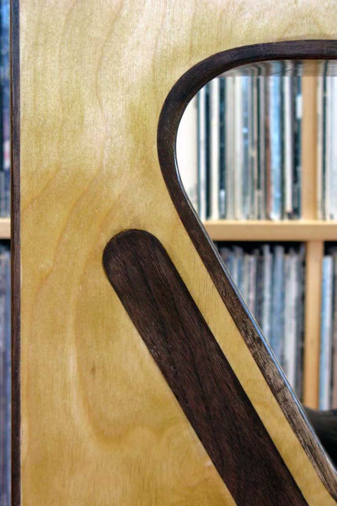

Construction: Russian birch ply for the sides; "Rubberply" for the curved faces (Rubberply seems to be made with a multiply-scored wood - Lauan or similar - veneer on each side of a rubber-like centre veneer), faced with paper-backed birch veneer; and walnut trim, solid except for the p-b veneer in the cutouts.

We run up against my ineptitude with Photoshop. If I make the image sizes more or less the right number of pixels to just scrape under the size limit, the file size seems to grow when I do a "save as jpeg"; so I've been playing it safe and making them around 89K size.
I'll try for some larger ones later, though with trepidation - the clearer shots will show the level of my craftsmanship far too clearly. 😀
Here's another small one to be going on with.
OK, the last one was "bigger" - just lower resolution. The others are all 200 pixels/inch, so you can drag them into a photo viewer and make them bigger if that's of any help.

Nice job Aengus
Thank you.
Regards.
Aengus
You are too modest, these are museum quality as far as I can tell.

That is very nice work indeed.
It just goes to show that with a bit of imagination the Harvey (and other Spawns) can be made into a thing of beauty.
You should be very proud.
Do you have any drawings to show how you adapted the original BVR design?

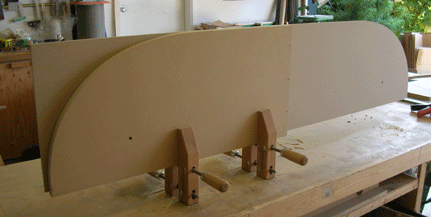

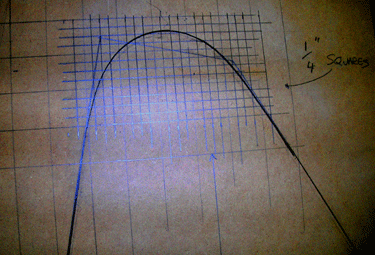

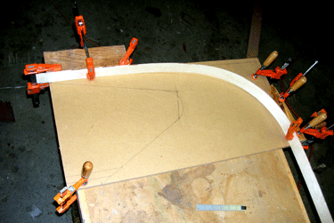

I drew the outer curve by laying out the original plan full size on a piece of MDF as big as half a side, then bending a batten to give a fair curve lying as close as possible to the original points.
Batten clamped in place:
