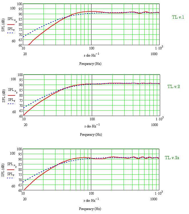

Yeah, I know. I was the one who did most of the pointing out of Thor's many issues over the course of two threads.
Anyway, FWIW, Zaph will probably be after our blood, but yes, a TL version of the floorstanding BMTM is very much on the cards (I was designing one as you posted), providing the cabinet width is maintained as per the original cabinet. A 'pure' Augspurger based 4:1 taper design gives a 58in line, throat CSA = 75in^2, terminus CSA 18.75in^2. Damp 0.84lbs ft^3 of dacron or similar & you get the first response attached. Alternatively, you can go with a longer 86.5in line, same throat & terminus CSAs for a lower & more damped tuning. 2nd FR is for that, with a 0.65lb ft^3 damping; 3rd is the same box, with damping reduced to 0.5lbs ft^3 to get a little more gain at the price of a theoretically inaudible increase in ripple.
Cheers
Scott
