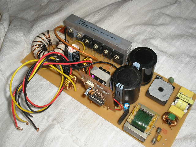

+63/-63vdc Smps New Prototype
Hello SMPS builders and friends
This is my new SMPS for power amp aplication.
I like it but I will build a control current togheter:hot: :hot:
Thank you very much
Sandro
Hi guitar joe and luka
Great stability, very fine. It's a SG3525/2 inch. core/4 X IRGPC30U/ half bridge SMPS project. In the start, I built it with IR2110 but I don't understand, the IGBTs stay very hot no load and the IR2110 explode after few minuts. Now, I get out the IR2110 and built a small core driver. Very good enjoy because the IGBTs stay "ice" and no fan is necessary in hard load.
Thanks by your comments.
Sandro
Hi
It looks ok, maybe a bit too low R value, I would use 22R, practical is somewhere from 10R to 100R
Supply wasn't a problem because you have used 50Hz trafo, so voltage was ok.
Bad layout? But even so, I really don't know how you could make it that bad that IR would heat up and die.
