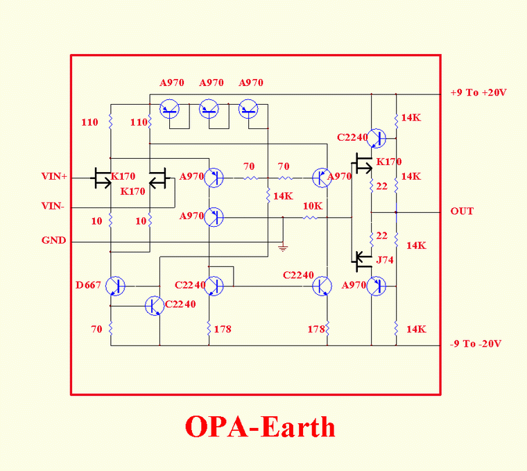

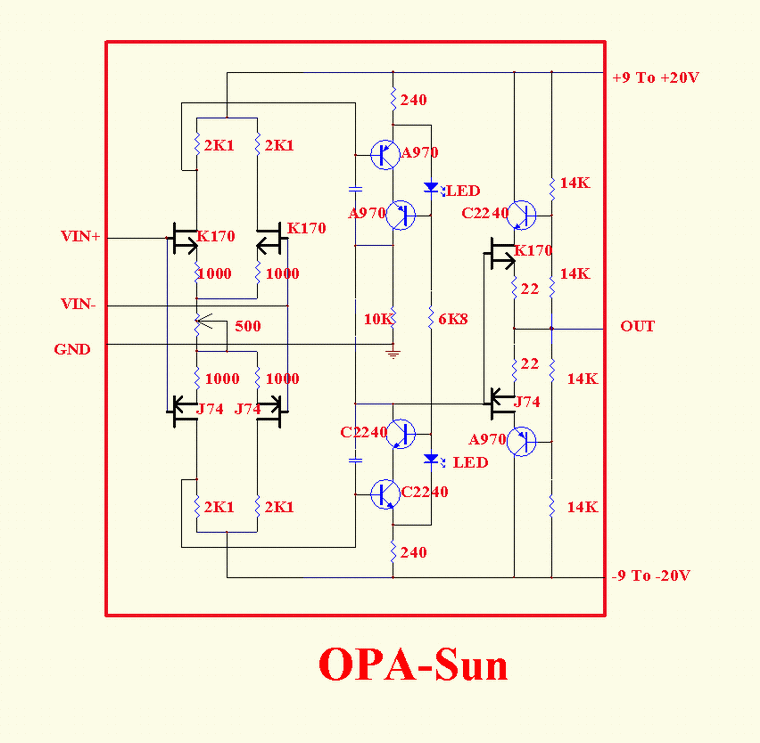

Hi audio-gd,
what benefits do you see in cascoding your output stage? At least in my simulation the performance was *worse* (more THD) than without cascode.
Rüdiger
Rüdiger

Onvinyl said:Hi audio-gd,
Hi Rüdiger,
This is not really a cascode, as the base is referenced to half the voltage between the output and the power supply, and not clamped to the output as it should be.
Hi forr,
I simulated this version and the version that is referenced to the output: both were worse than no cascode at all!
Rüdiger
Rüdiger
