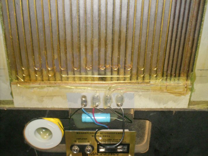

This is rear of the left speaker (in my setup) before repairs were started. The tweeter panel is normally on the extreme left, when one is in the "listening position" in front of the speakers. Here it is just visible on the right of the panel, comprising the fine red wire.
The bass section makes one full circuit, beginning on the left and completing 12 upward and 12 downward runs between the magnet poles. The wire then runs along the base of the diaphragm to begin another partial run, with 4 upward and downward passes on the extreme left side. The centre is bypassed, then a further 3 passes are made on the right. The wire is then returned to the terminals.
The ends of the first and second passes are offset by 3/8", and I used the end of a 5/16" drill to form the end of each loop.

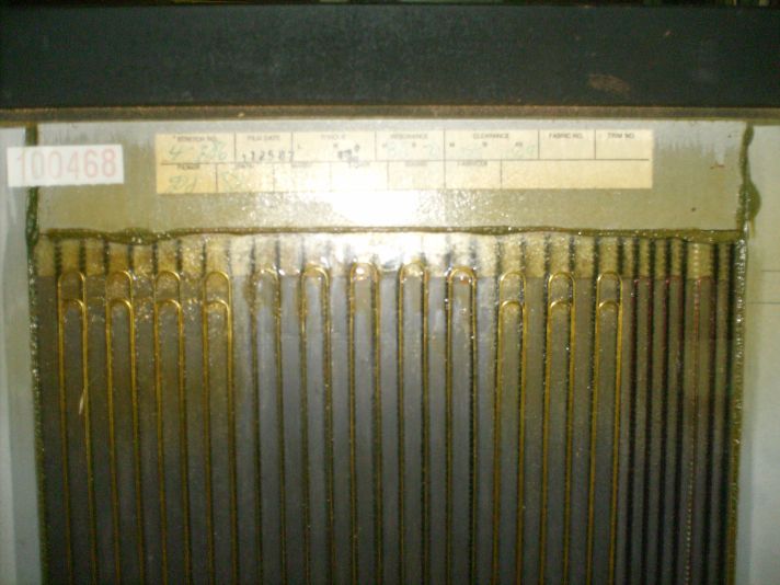

Second panel is underway. Though I hadn't noticed whilst listening, the bass wires were in a poorer condition than the first speaker. Many were loose and overall, very poorly stuck at this stage. Production notes on a label inside the speaker indicate that this pair was made in 1987. If I get this repair right, I can hope for another 20 years!
