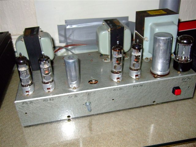

A moral boost for my DIY tube Indian friends. Actually this was not made by me. This was partially made by my friend’s father in 1960’s. He never completed it. Preamp section was using EF86 and the power amp ECL86. I slightly re-engineered by changing the preamp to ECC83 tubes, which I bought from e-bay. I don’t think so it is a very high end configuration. But I liked very much. I definitely liked the sound. Indeed the sound is different from solid state devices. I am very happy with the sound.
