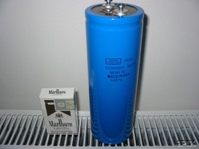

when we´re talking CG caps , look at this one!
That´s what I call a capacitor!
Forgive my macho-ism, but I really, really like them.
Have 8 of those (220.000 uF, 50 V) that will be in my next amp project. Each one stores 275 Joule !!!! at 50 V

Hi Franz,
Such monstercaps look cool, but isn't it always better to use a lot of small ones, since these should have u much lower impedance and therefor a better sound?
Lucas
Hi Lucas,
I don´t have the figures at hand right now but you must not forget that a cap of this size has a a priori much lower ESR than a cap of say a 10th its size. So you won´t always get a much lower ESR depending on what your muliple substitute caps are.
Plus you can also parallel the bigger ones !!!!
I ´ve been thinking about this question for a long time as well, but if you look at current Pass production models you won´t find a multitude of small ones. Nelson still favours the big boys. I think he knows why.
In general however I think your statement is true.
What do the amp experts think ?
Franz

Hi Franz,
Indeed, Nelson and a lot of other manufacturers use those large caps. Maybe it is also much more economical for them to use one bulky instead of a lot of others. It may even look cooler in the publicity...
I saw that some others like Classé Audio use a lot of smaller caps, claiming that it brings more "speed" in the sound.
Who knows? I have never done a comparison.
I think Daniel's method is very clever; in his extremely beautiful Aleph X he uses two large caps for the first stabilizing, followed by a lot of small Panasonic FC's close to the mosfets.
This seems to me a very clever solution. When biulding an Aleph X I may try this too.
