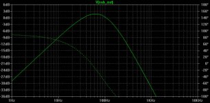

Please tell me what you think of this design and how it could be improved.
The basic concept is a L+R mixer, normal / reversed phase selection, 12dB/octave crossover with selectable crossover points, and an output buffer to drive a single cable to a powered subwoofer. The subwoofer will have a Linkwitz transform circuit tuned for the driver and box plus a power amp.
pdf of the LTspice circuit , jpeg of simulation result

gregorx said:Why does the output attenuation change with frequency selection?
It's the same curve, just translated 10Hz with each step. LTspice file attached if you want to experiment.

The amplitude of the curve appears to change also with the frequency unless I am just completely seeing something incorrectly.

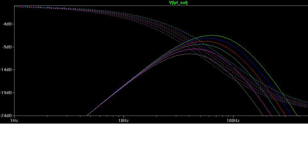

Ok I got it to run. I was confused previously by the stepped attenuation in your simulation. I turned those off for a second (but I am going to copy them for my own simulations soon) and made the attached graph.
I like how fast the high end rolls off but assuming I did the simulation correctly --big assumption-- it appears that the low end rolls off too quickly.
There's two sets of spice directives - one for the AC simulation which steps the resistor values to change the crossover point, and one to step through the gain values for a time domain simulation. I toggle them between comment and spice directive depending on which one I want to run.
Delete the two 0.22u caps on the input to get rid of the low end rolloff.
deleted caps. looks good now 🙂
