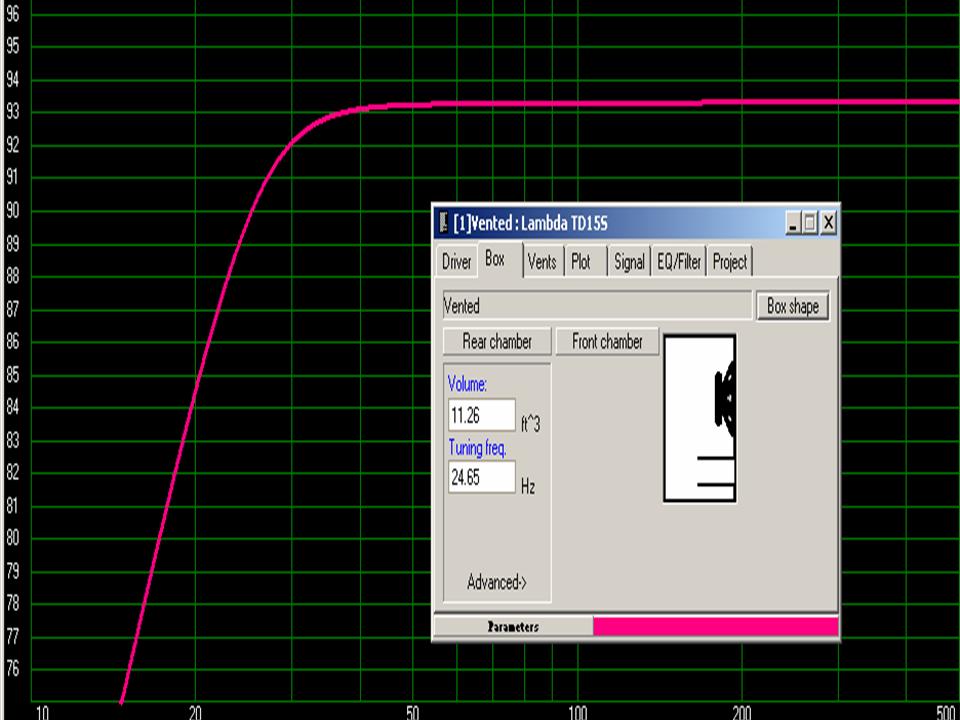

One possible Consolidated Construction Strawman could be an 18" waveguide crossed at 800Hz to a state of the art 15" woofer which could cover 25Hz to 18kHz.
The AE-Lambda team is promising a few new 15” woofers with 99db/watt underhung motors, and these seem worth watching. The attached graph for a production 93db/watt Lambda 15S in an 11 ft3 ported cabinet – Altec Nineteen volume

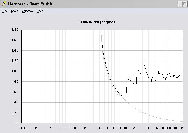

@ Linesource: 18 inch waveguide indeed seems to be optimal, regarding the directivity matching of woofer and tweeter. Below is a hornresp sim of the directivity of a 18inch wg and a 15 inch woofer. They perfectly overlap around the crossover region.
We also see the problem which conical / os waveguides have, a slight narrowing followed by a widening of directivity around the lower cutoff of the wg. I dont know how Dr Geddes works around this problem.
