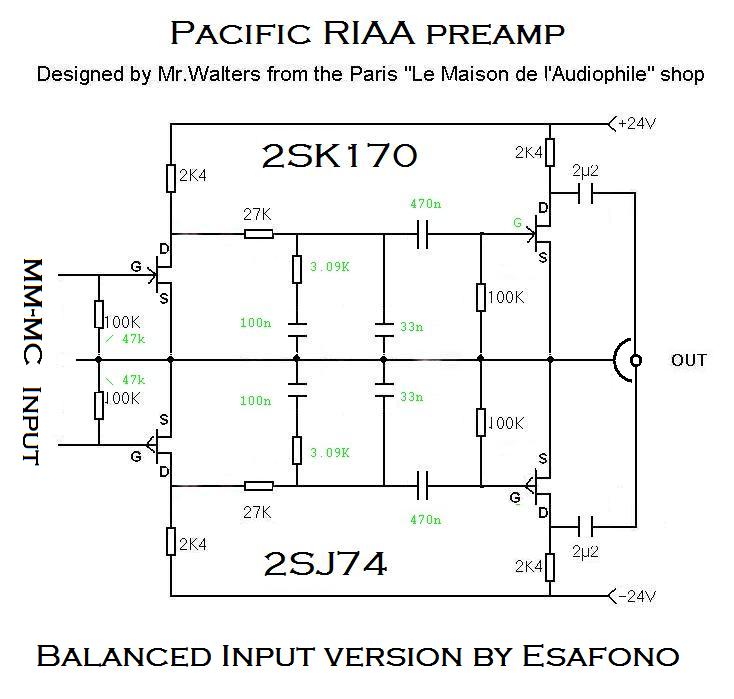

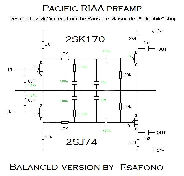

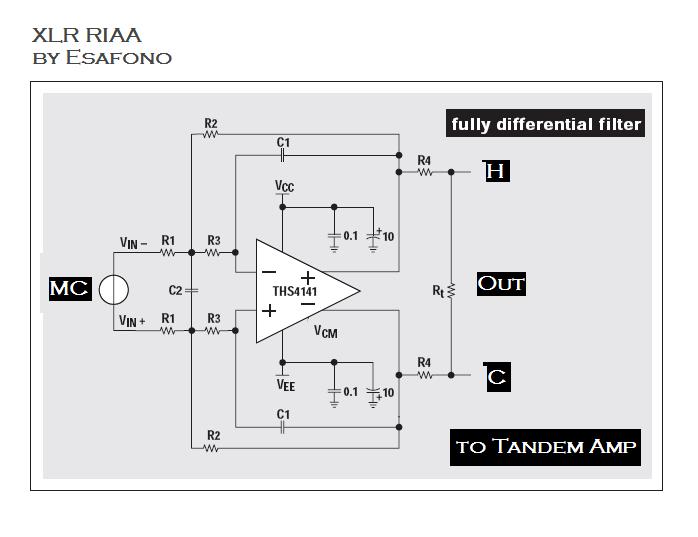

Running the cartridge balance is a very good idea (says the guy who runs his cartridge balanced). These are just not good implementations. The second one will have degraded noise performance.
There are (to my knowledge) two good ways to do it. One is to build a fully differential phono input, the other is to use a transformer at the input and run the primary balanced. The secondary can then drive the input of a conventional single-ended stage. You get 99% of the balanced advantage that way.

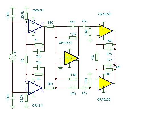

do you have a schematic of fully differential one?
http://www.esafono.it/diff.jpg
this is just a project with OPA1632

Only with tubes, but I'll bet there's a transistorized one around the forum somewhere. The "search" function is your friend.
Here's an example of a tube one:
http://www.vacuumstate.com/schematics/rtp3c_s.gif
edit: The one you linked to looks much better.
edit edit: "Better" than the first one, not better than the Vacuum State one; sorry to be ambiguous.

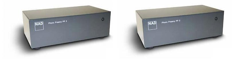

an uneconomic improvement
certainly difficult to discriminate between contributions...
now I have an economic turntable - kenwood
with economic MM head and shielded container (on the ground)
no hum
test you also
it's easy with great satisfaction
But attention
must buy a second complete electronics once heard this quality!

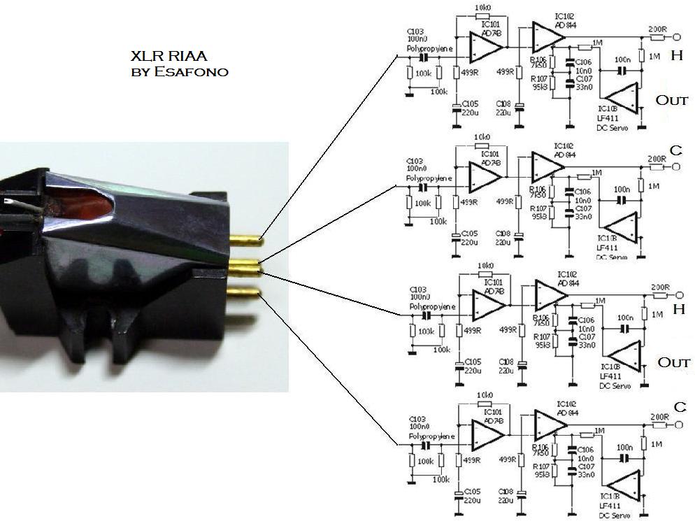

(or build a fully differential one)

sorry the output of last schematic is unbalanced
ideal for unbalanced input amp but with balanced out
http://www.esafono.it/Esafono_Tandem.pdf

Differential DIY OPAMP -- Scott Wurcer posted under "Measuring Low Noise" -- instead of 2SK170 uses BF862.
This is from Tubecad http://www.tubecad.com/2007/09/blog0120.htm
adapted a bit for the situation -- so full credit to Broskie
