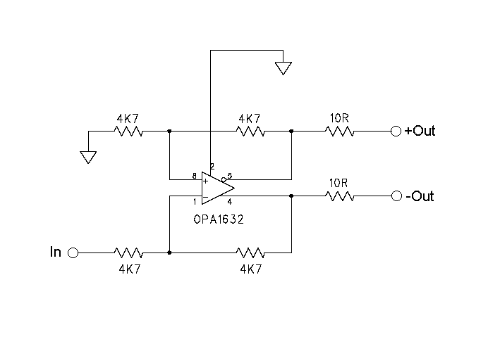

juma said:
OpAmps are second choice parts for this job. To do it properly you need a fully differential amp (OPA1632,THS4131....)
AFAIK, using a diff opamp will actually make a very mediocre phase splitter.
The best topology for phase splitting with opamps is this:
Which is what the inside of a DRV13x chip looks like.
HOWEVER, it is silly to use an opamp to do the splitting for an Aleph IMHO. The Aleph frontend should do a better job of phase splitting itself. If you absolutely need more gain I suggest you look at a discrete phase splitter.

The reason i do not use an Aleph pre is because it does not fit in the nad T162. The NAD tuner/preamp has no balanced output.
I can use the power supply of the NAD to drive an op-amp, to build an balanced output.
Last question,
Is this the circuit to use to go from unbalanced to balanced ?
I build the drv134 version, the problem that i have more noise than sound ?
The Amp for wich i will use it, is an aleph 5. When i put 2 capacitors in the + and the -, the noise dissapear. Why is it not possible to drive the aleph direct by the drv134 ?
I cant see why you cant drive Aleph 5 or any other power amplifier
directly from DRV134.
About putting caps, I suppose you mean SERIES Output caps.
When you have not a stable DC output 0 Volt level (some dc-offset)
you may need output caps to get it to work well.
You can try without caps, and try different levels sound output
while measure any DC-Voltage at those two DRV134 outputs.
If you get any substancial DC-Offset output,
you should use Output caps.
