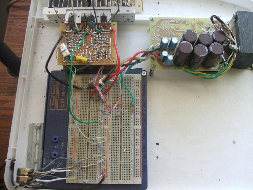

I was going to add some of these shots to another thread after a D.I.Y. member contacted me regarding their latest build, and he commented that all the amps he had constructed ( including my design on this Forum ) sounded totally different ( by the sound of it very very different ). Having seen the layout and pictures I couldn't help thinking that layout was as much to do with it as anything.
As it may help others I've decided to put it in it's own thread.

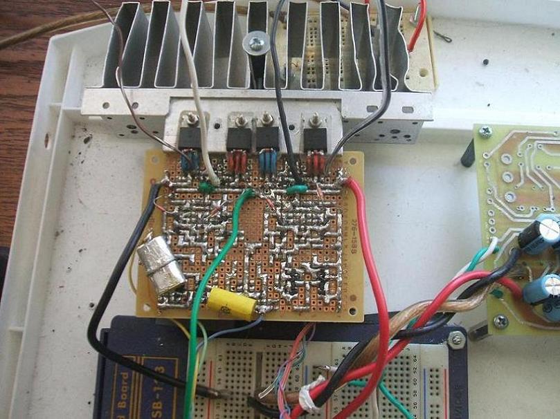

First shot then is the amp--- and how not to do it --- but as this is similar to many "veroboard type " constructions I think it valid.
The design is based on my own MOSFET amp but this is different, I've been playing around with some HEXFET's and this is the result so far.

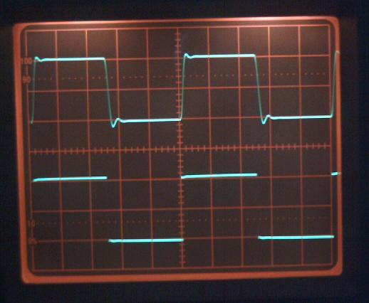

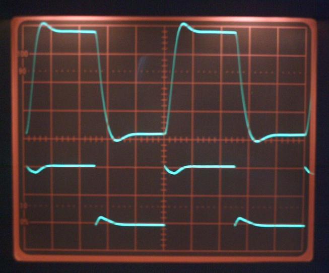

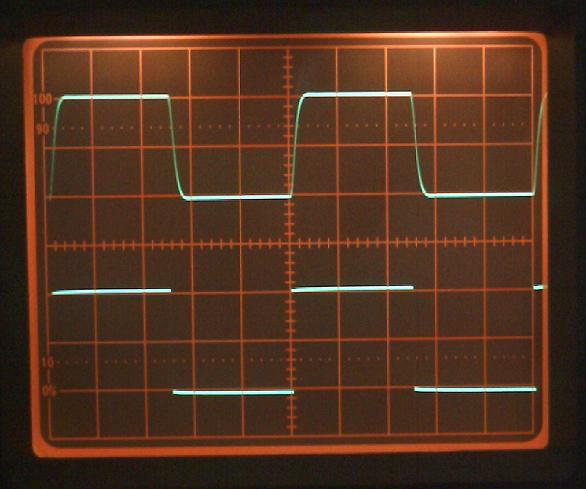

And the same, correctly grounded and supplying a load of 2.7 Ohms. This is a very severe test even though the amplitude is low at 4 volts peak to peak.

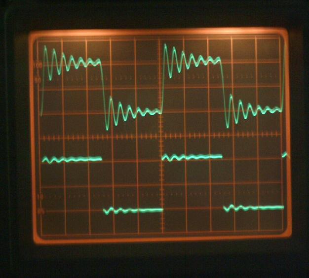

This time with the output returned to the wrong point so that the input ground is "contaminated" by the output current.
This is the only thing to have been changed -- compare the traces to the one above. Note the amplitude of the output now !

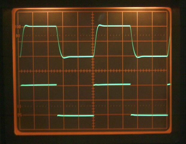

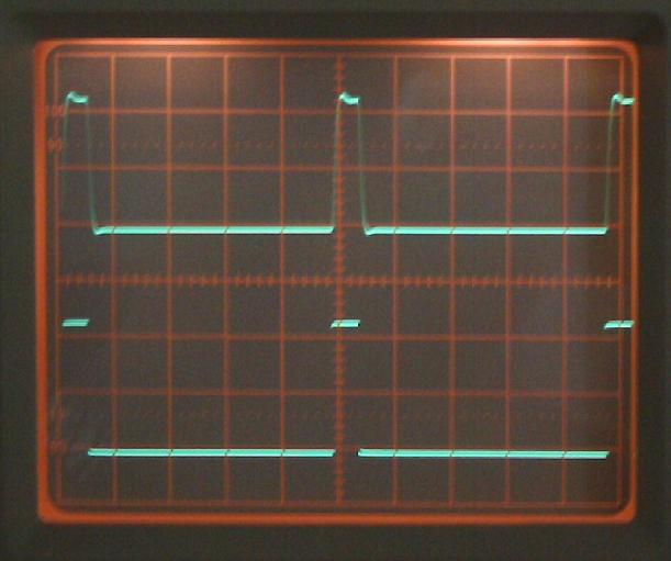

A more severe test. The little PSU I am using cannot supply much current for sustained testing, but this is a good trick. Here is 12 volts Peak/Peak across the 2.7 Ohm load but with a lower duty cycle. The load was correctly terminated.

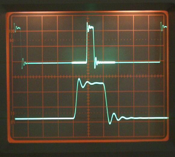

Last one, a shot showing a detail of using an incorrect ground. This was as above but with a 0.1 Mfd again as the load.
This was all a bit of fun on my part, I wanted to play with some HEXFET's, but it seemed a good opportunity to put this down so to speak. On a side note the amp design I use (single ended input) is very very stable and an amp with a differential input pair would give far more extreme results than this, with this type of layout . Try as I might it was hard to provoke this lash up into oscillation. If you look at the first shot you will see there is NO decoupling on the plugboard at all, and still it's stable.

I use breadboards much less than I use to. They are pretty much used as quick connecting sockets or for simple test circuits. Any circiut that you intend to have operate at high (RF) frequencies, old worn out solderless breadboards just will not do. Vero-board is the stuff for amplifier prototypes. It is actually quite handy for SMD circuitry, specifically SOT-23 and cheap 603 or larger resistors. It is surprisingly easy to change the circuit around. The solder is "sculpted" around the circuit components so building a symmetrical circuit with a symetrical layout is easy, just place the opposing transistor upside down.🙂 I've even used SOIC-14 components in this manner.😀 If you cut the small pads around the holes in two then the SOIC pins line up perfectly.😉
ex 1
ex 2
ex 3
As for long term reliability? Probably not that great. Solder does dry out and crack. However, I will say that this amplifier is still in perfect operation after over 8 months. :xeye: :smash:
The input filters are on the vero-board. Notice there is a separate wire for the output's decoupling caps to the "star".(thick green wire from veroboard) The input GND is connected to the source common GND, then to the star.
Note: this is 1 channel, SE input, BL output so the speaker doesn't connect to GND. If it did, it would ground at the star via another separate wire. Of course in this circuit, any load from output(s) to GND will miss-balance the bridge and it will not remain stable.:dodgy: But then that's not the intended output anyway.😎
