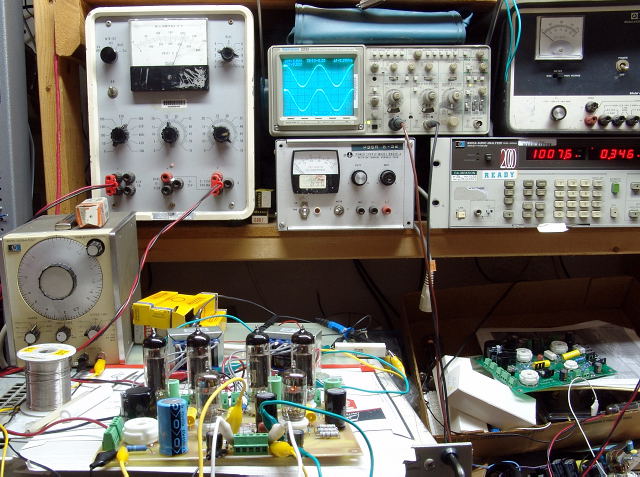

I have been working on laying out a PC board for the big version of the Simple P-P. I have worked on it on and off for the past six months. I have come to the realization that two channels and a power supply will not fit on any reasonable sized PC board. Four octal output tubes with minimum spacing between them takes at least a 10 inch wide board, and that is ruling out fat bottled tubes like the KT88. I have started about 5 different designs, got frustrated and gave up. I think that the octal version of any type of Simple P-P will have to be mono blocks.
About two weeks ago I decided to put it on hold for a while and do something fun. I had a discussion with a friend about a "spud" amp a few days before a three day weekend. That resulted in a new design and a new PC board which was seen in another thread last weekend. I even got to crank up some tubes and make em glow. I had too much fun, so...
I took two more days off of work. There was the matter of the smaller version of the Simple P-P. I have two designs on my Tubelab 3 prototyping system. They both work, and are very similar except for the tube lineup. I took a guess and assumed that the EL84 version would be the most popular, and decided to lay out a PC board for it. Besides I have another reason for doing an EL84 board that I can't divulge yet.
By Friday I had a good PC board design. Friday night, I made a PC board. Today I drilled it, and populated it. This evening I hooked it up to my power supply, and plugged in the first 12AT7. It lit up and the voltages were about right. Then I attempted to plug in the second 12AT7. Do you see the problem here?

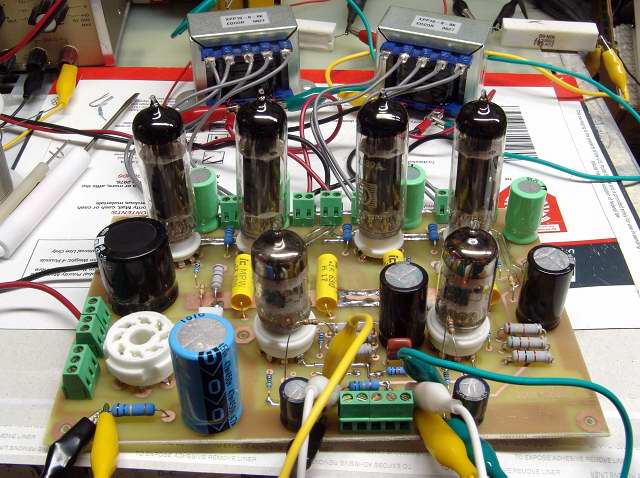

Is that a little issue of Chinese hole tolerance? I actually had a 9 pin PC mount socket that came with solder in one of the pin cups... I've been enjoying PCB design lately too, but my EL84 PCB is still in development. I'm still getting a feel for how much space I can leave between traces without screwing myself.
-Paul
-Paul

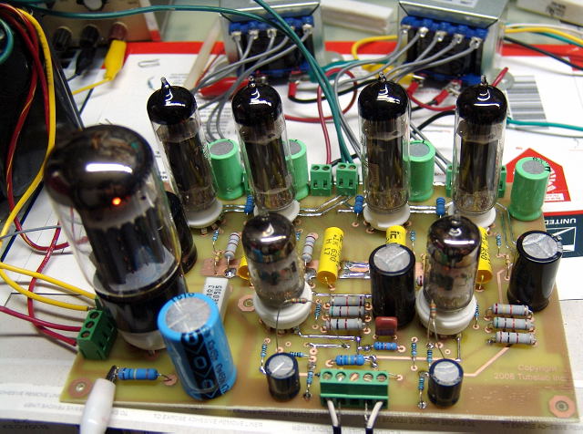

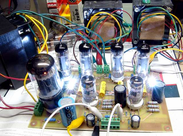

Well I decided that the tube WAS going into that socket since it wasn't much fun to change the socket. Application of excessive force only resulted in a broken tube. After a few other dumb ideas didn't work, I resorted to a PC board drill bit in a Dremel tool set on max speed. Zipped right through the substance that the Chinese call ceramic. Second 12AT7 installed and working.
There was no B+ getting to the right channel OPT. It was an open trace in my low quality PC board.
Other than these two issues, the amp works very well. 15 WPC at 0.45% distortion. 16 watts however will get you 4%.
Here the amp is still running on a bench type lab power supply. This lets me pick the voltage that the amp likes the best. I decide that 320 volts is where I want to be.
I adjusted the global negative feedback to 6 db. This seemed to still leave the music alive, while tightening up the bass. I attached speakers and a DVD player, and rocked the house!
I take a guess as to what transformer will make 320 volts DC. In this case it is an Allied 6K56VG, which I hooked up. I put in a rectifier tube, and cranked it up. There is no choke in this amp, and there is no hum.

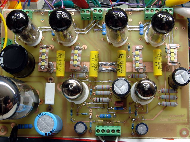

OK, SY you put me up to this.

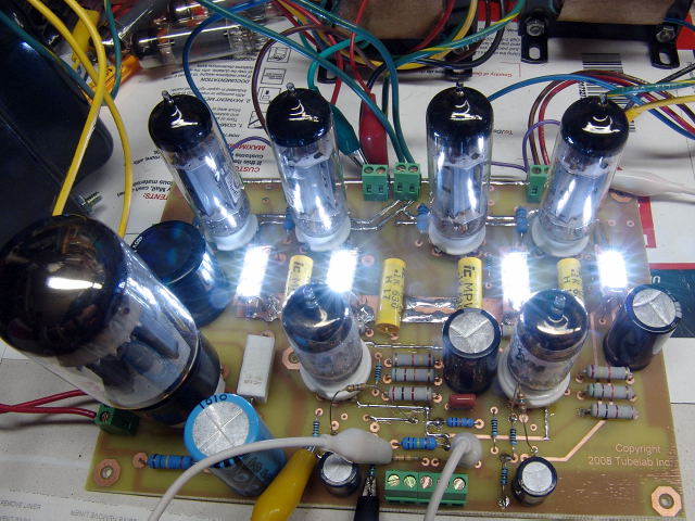

I got to thinking about putting some LED's in the cathode circuit of the output tubes. I looked around here but couldn't find enough LED's that were all of the same kind. Then I remembered some white LED's that a friend had given me that were made for the flash in a camera phone.
These were surface mount creatures and they were not made for continuous duty. I didn't have too many of them either. I soldered some wires on one and connected it to a power supply in constant current mode. First off, they were BRIGHT! The voltage across one remains pretty constant once the current is above 20 mA. I cranked that one up to 150 mA and it didn't fry, but it got pretty hot after about 10 minutes. I cranked the hot LED to 200 mA and it was still alive. OK so far so good. The voltage was 3.4 to 3.5 volts. I measure 10 volts on the cathodes of my 7189A's so 3 in series should be about right.
Next, I needed to put 3 of them in series and heat sink them. I hand carved 5 PC boards made of some ceramic material, mounted 3 LED's on each and tested them. I picked the 4 closest ones, based on forward voltage drop. I measured and plotted the V/I curve for all 4 units in 10 mA increments from 10 mA to 100 mA. From this curve I computed the dynamic resistance for the LED string. The resistance is non linear up to about 40 mA but remains a very constant 5 ohms from 40 mA to 100 mA. This is good.

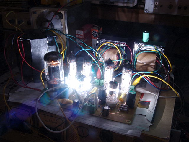

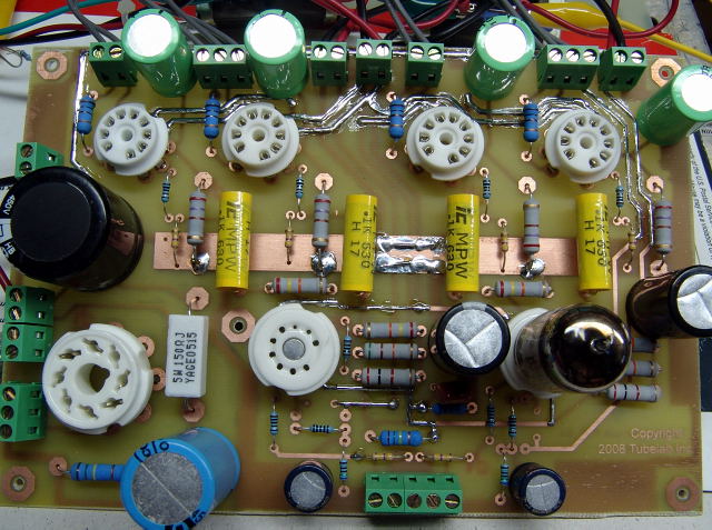

I removed the cathode resistors and their bypass caps from the PC board. I put one of the LED modules in the place of each cathode resistor. I can run each output tube individually on its own LED string, or run a jumper wire from cathode to cathode to run one channel (two tubes) on a parallel pair of LED strings.]
Here is a photo of the modified PC board.
The amp is still wired in pentode mode. Power is still 17 watts but the distortion has decreased to 3% at 17 watts. Connecting the two cathodes together raises the distortion to 4.5%. The same effect was noticed at 5 watts. Distortion was 0.4% without the jumper, and 0.97% with the jumper. I removed the jumper. The LED's are bright, but the light is constant even into clipping except for very low frequencies like 5 Hz where they blink like crazy when the amp clips hard.
I hooked up the CD player and speakers and cranked it up. I must state that the cathode bypass caps (now removed) were cheap junk (all I could find at the time). The bass and transients were remarkably more vivid. It seemed that the mids and the sound stage were more obvious too.
I only had about a half hour to listen to it, but I like it. Just 2 weeks ago if someone would have told me that I would be listening to a P-P amp in pentode mode and liking it, I wouldn't have believed them. Maybe the 3 year episode of the SE fever is subsiding.
