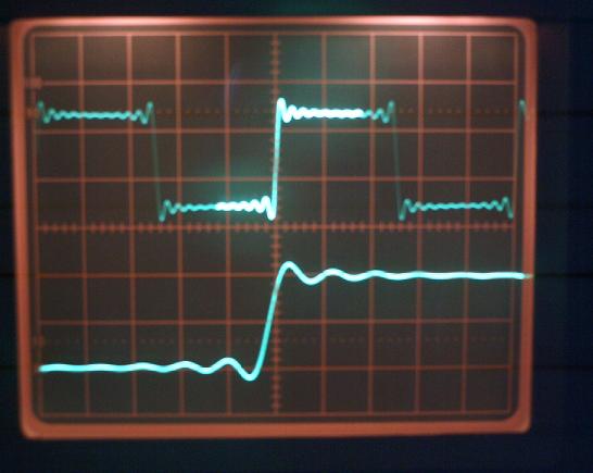

Dual trace is a must have. A dual time base is nice and let's you do this (see pic) to expand and look at in detail ANY part of the display.
Edit -- If John is reading this, I nearly posted this picture in the "Output inductor thread" as a reality check on slew rates 😉 I thought better of it though 😀 😀
It shows a 1Khz squarewave as reproduced by a CD player with the trace expanded to show the ringing caused by the reconstructive filtering.
