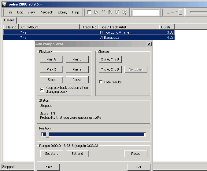

ABX Blind Testing with foobar2000 Tool
A nice and interesting feature with foobar2000 http://www.foobar2000.org/
is that you can install it with an ABX Blind Test tool.
It comes with the default download installation.
Called ABX Comparator
1. you open 2 soundtracks with foobar2000
2. you select them both
3. you right click and select 'Utils' = ABX Comparator
4. you are presented with the ABX Console window.
See my attached image.
I have selected 2 totally different tracks.
So no surprise I did score 6/6.
Verdict:
Probability you were guessing: 1.6%
This opens up the possibility to make your own random ABX Testing.

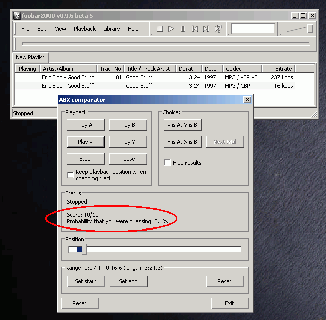

I created 2 MP3 tracks from same high quality Music track.
The first track is 237 kbps. The second was 64 kbps = smaller file.
Then I tried to identify A vs. B and hear some difference.
But I found it was so difficult to hear any difference, so I didnt do an ABX blind test.
Instead I made the a new MP3 file, only 16 kbps bitrate.
And so I thought could hear a good difference.
Now I did an ABX of these 2 tracks:
- mp3 237 kbps (this one size: 5927 kB)
- mp3 16 kbps (this one was only 400 kB file)
See attachment.
I scored 10/10 .. and so there is not much cgance I was just guessing.
I truly could identify! I heard the drumbs better in one track, especially.
Verdict, you can see: Probability of guessing: 0.1%
As you also can see, I had defined a very small part of the track,
that was played for each trial.
I might try to distingush between 237 kbits vs. 64 kbits.
But i am neverous.
As I can hear almost no difference

Foobar is a great player with a lot of great plugins. Fun!
Don't be too bummed about the ABX thing. I tmay not be you, but your soundcard, DAC, amp, speakers, etc.
The low birate stuff sounds nasty to me, but a lot of the high bitrate is very good. Same with jpegs in image files.
Now you have a tool to test your system. As you improve the system, you'll be able to hear the difference more and more. That's resolution.
