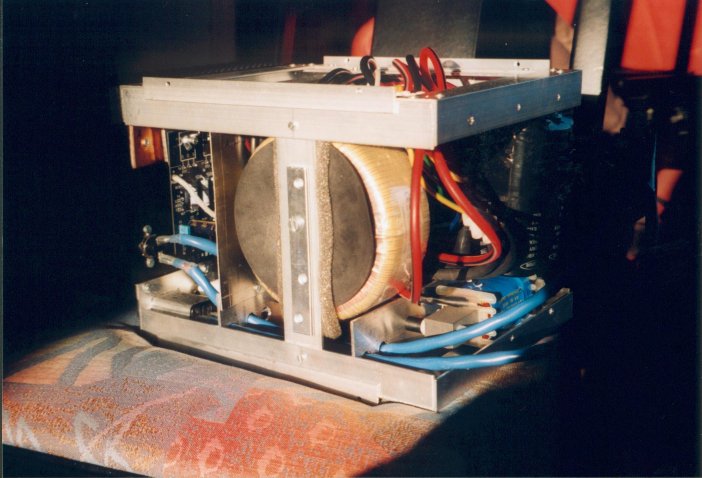

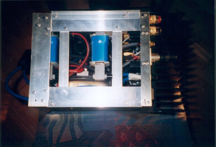

I have finally got some pictures of my two new Aleph 5 monoblocks.
They were taken some 10 days ago when I had just started to listen to them.
You will see them in their naked version.
Meanwhile I have added the wooden sides and the aluminium tops and bottoms. The frontplate will be professionally made in a later stage.

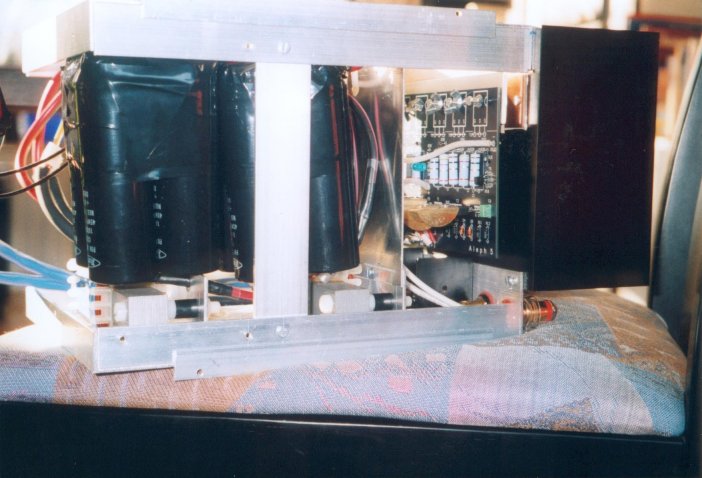

In this picture you see the side of it:
The Condis were still not fixed, but hey cvould not fall out...

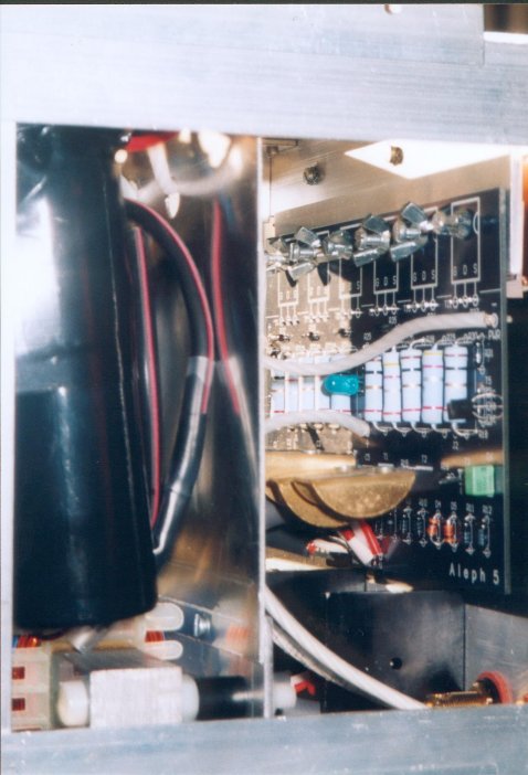

These PCBs are Kristijan's...
I attached folded brass dog-pennings for cooling the 9610s.
Under the PCBs you first get a nylon ring, then an alunminium stripe, then the IRFP 240, then Kapton (non-grease) isolation, then a 3 mm thick redcopperbar, then grease, and finally the Seifert Heatsink, measuring 216 x 150 x 84 mm.

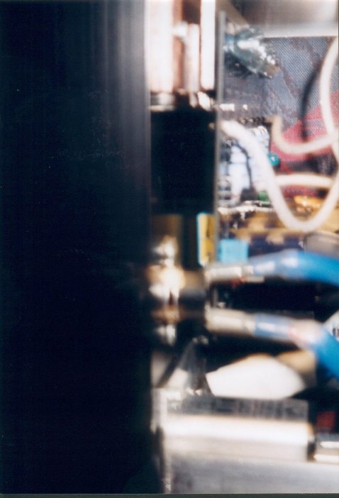

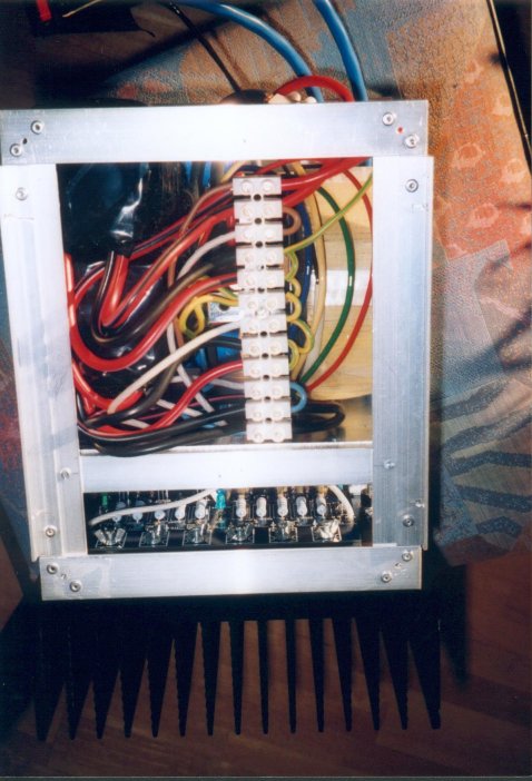

Here is a final (rather dark) picture where you can see the wooden sidepanels in a still rough state and one of the aluminium grids for the tops and bottoms.
(They have been installed now but I don't have a digital camera. I will post them later...)
Some remarks on the components used:
The toroids are 30 VAC 330 VA from Reichelt, Germany. Very cheap (33 Euro) and very silent.
The Condensators are 45 Volt (56 Volt surge) Marcon 16.000 uF. I used 2 sets of 4 pieces in each monoblock, divided by Intertechnik 3,9 mH 0,24 Ohm I-Point chokes.
I use two rectifierbridges for each channel.
The 30 VAC result in a 39 VDC under load.
One channel delivers appr. 30 mV DC offset, the other one is around zero!
I matched all mosfets, and I also matched the 550BC on HFE.
I used 0.25 Watt 0,1% precision resistors made by Welwyn, and 5 Watt MOX resisters made by Intertechnik.
Since I too have 4 Ohm speakers I decided to use the resistorvalues of WuffWaff that he has posted in another thread. This leads to a higher bias.
The Seifert heatsinks reach a temperature of about 47 degrees Celsius at a roomtemperature of 20 degrees. The redcopperbar on which the mosfets are attached reaches 53 degrees.
We can therefor conclude that the redcopperbar is a good solution.

grataku said:
Is it just me or the pictures? I have been looking at these for the past five minutes and I have almost no idea of how this amp looks or it's put together. 😕
I had a good laugh reading your comments, which as usualy, are right to the point.😉 I guess too many close ups and not enough wide angle photos.
I also noticed unique way of mounting output devices, very practical.
So, it is nice.
It works, so very nice I guess.
So, it is nice.
Hi Grataku and Peter,
I already had this fear when I posted them... :cannotbe: , but you DIY guys like puzzling, don't you?
I had a very simple camera at my disposal and the light conditions weren't very ideal, I guess.
I will make some more (and hopefully better) pictures with the sidepanels attached.
BTW, I thought that you DIY guys are more interested in naked photography than external cosmetics....😉
Anyway there seem to be no questions, so it can't be that much confusing. (Or it is too confusing to invoke questions...😕 )

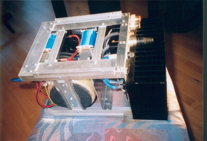

Peter, I used 30 mm M3 bolts that went into the heatsink up to the maximum end. Then I could easily raise tension on the mosfets by turning the butterfly nuts. This way you can use the maximum available thread within the heatsink and it doesn't put pressure on the thread while turning around...
Anyway, thanks for all your attention!
Lucas.
