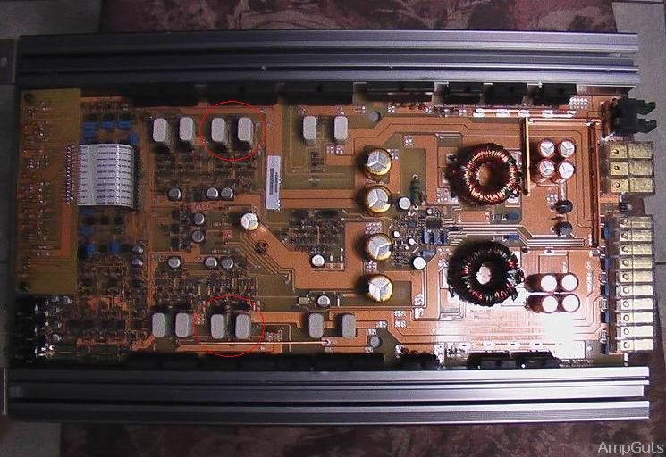

What kind of problems? Well, channels 3 and 4 died first. Then, quite some time after, the sub channel died. Then, shortly after that, channels 1 and 2 died. I always ran the amp fairly hard, and it is extremely hot here in the summer, so I'm sure that didn't help.
What I mean by died, is that the output started to sound kind of crackly, then after a few days/weeks pretty much no output. At that point, any sound that there was was extremely crackly sounding.
After the first set of channels died (channels 3 and 4) I took it apart. I noticed that some of the white components (I think they were resistors) looked a little discolored. Everything else looked pretty normal (and yes, I took the clamps off the fets). The white components are circled in the image (image taken from ampguts and I added the red circles)

Your amp has a sub power supply and a four channel power supply the darker looking toroid is the sub supply. It sounds like current limits have let go on your amp, This would explain the eventual loss of all the channel over time...but it should be benched to gain perspective of its real problems...

It may not be difficult to repair. The symptoms sound like power supply problems. These amps have problems with the busbars. The connections break and cause various problems.
If you can power it up and are willing to check voltage on various points, I'll tell you what to check.

The busbars are the metal jumpers. It's not likely that you'll be able to see any of the bad connections. It would also be difficult to find them with a meter.
You'd need to power up the amp and check voltage at several points. When you found that voltage was absent at a point where you should have voltage, you'd trace the problem back until you found the break.
If you don't have the ability to work on it easily, it's probably best that you pay to have it repaired.
