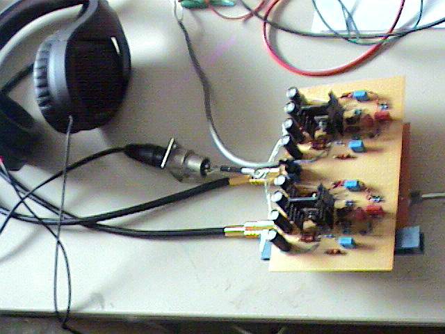

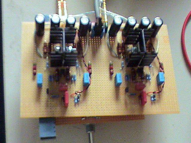

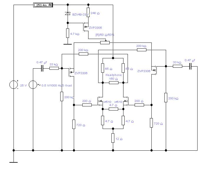

please comment this headphone amp.
Is it working in X- mode?
I`m using it with separated grounds via a
5 pole Neutrik plug. I think it sounds pretty
good. The powermosfet have some headsinking
and are joint together. Diffpair glued. All
fets are paired. When i can take a cam i will
post some pics.
Bye everybody, Andreas
