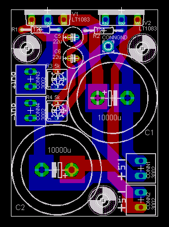

I'm finishing a pcb-layout for a voltage regulated psu-board for dual rails (like +/-35V) which uses the LT1083/LT1084/LT1085 regulator (the high power (7 A) TO-3P variant) for both polarities. I'm going to power my power amp with it.
It is very small in size, currently 50x70mm, double sided, has very fat tracks (150mills for the regulated side), has well separated tracks (20mills average track clearance) and will be manufactured with heavy copper (70um).
One board gives both voltages (adjustable from +/-1.25V up).
This is the first time I'll order at this boardhouse, but I've heared the board edges are cut - not milled - so probably don't look that perfect as you're used to. However this does not have an impact on functionality (just looks).
Big advantage - they're cheap.
Cost depends on number of boards, rough guess is about 18 Euros per board for 4 pcs (that I need), of course dropping with every board that comes in addition.

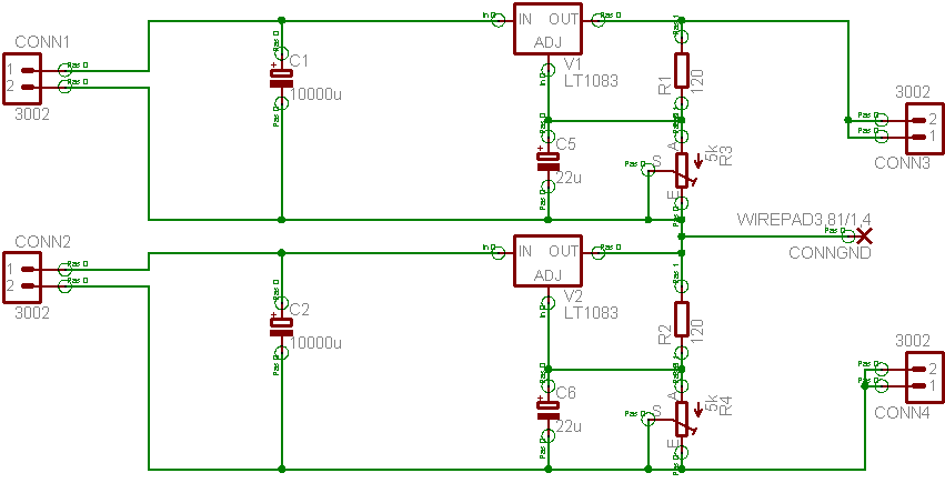

Schematic
Please note that caps on the regulated side are necessary and that I did not provide space on the pcb for them. They should be mounted on the amp board anyway, so that they're close to the load.
Board
To be able to choose a suitable heatsink depending on the load, I think it's most comfortable to use an external heatsink, off-board to be flexible. So you can use something small for your preamp, but a real chunk of alu (1-2 K/W) for your power amp.
To be able to use thick or multiple cables I used the dual Molex-connectors in parallel for the outputs, so to get lowest resistance. For the ground connection I use a soldered connection.
Maybe some cosmetic changes are left to be done, but otherwise that's it.
I'm happy about every comment on improving it further!
Feel free to mail me directly if you're interested (or post here).
Have fun, Hannes
Hi agent.5,
yes I've considered all your points; the diodes are not necessary for this regulator as it has an internal diode (capable of handling microsurge currents of 50A to 100A!). You can check this in the datasheet :D
2 reasons I didn't add a Vout cap: first this cap should be close to the load, preferable without parasitic wire resistance in between. 2nd there's simply no space! The size is fixed and you can see there's simply no space left! I would also have added the option for using the dual as 2 single rails, but same story.

Hi P-A!
Of course! That's the reason I use 2x 15A molex connectors in parallel for the outputs, to get the parasitic resistance to a minimum. Mentally I just add the cabling to the ESR of the cap, which is higher than some centimeters of wire anyway.
From reading the datasheet it is for me unclear why you want to use a bypass, since a 22uF Tantalum or 150uF elco gives perfect stability (as the datasheet says under all conditions). AFAIK Elcos have a rather weak high frequency response, so depending on the regulator this could be needed.
Maybe you could give me a hint on this?
Thank you very much, Hannes

It's not a good idea with a non-tested pcb. :no: We have had successful group buys but the boards have also been debugged properly. Why don't you order from Olimex a couple of boards first? People here are used to professional boards in most senses.
My advices:
  1. Check the design!
  2. Write pcb name in every layer (but in some layers it can be placed outside the board)
  3. Write revision number or letter in every layer
  4. It's also a good rule to write the layer name in the layer
  5. Correct the silkscreen so all designators are clearly visible when the parts are mounted
  6. Check trace widths. Unnecessary thick traces in some places
  7. Check drill sizes. > 0.2 mm more than the thickest component pin
  8. Check pad sizes (a bit small in some places)
  9. Check part dimensions with the pcb symbols
    [/list=1]

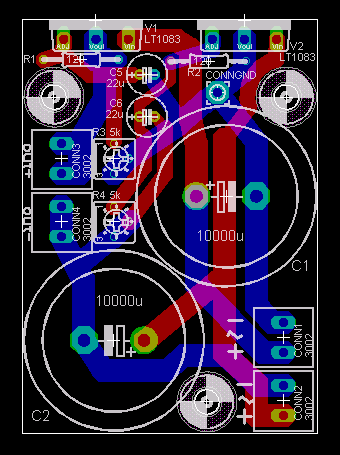

Now that completely escapes me. What's the disadvantage? I can only imagine that they're harder to solder? An updated artwork did already consider this :D
