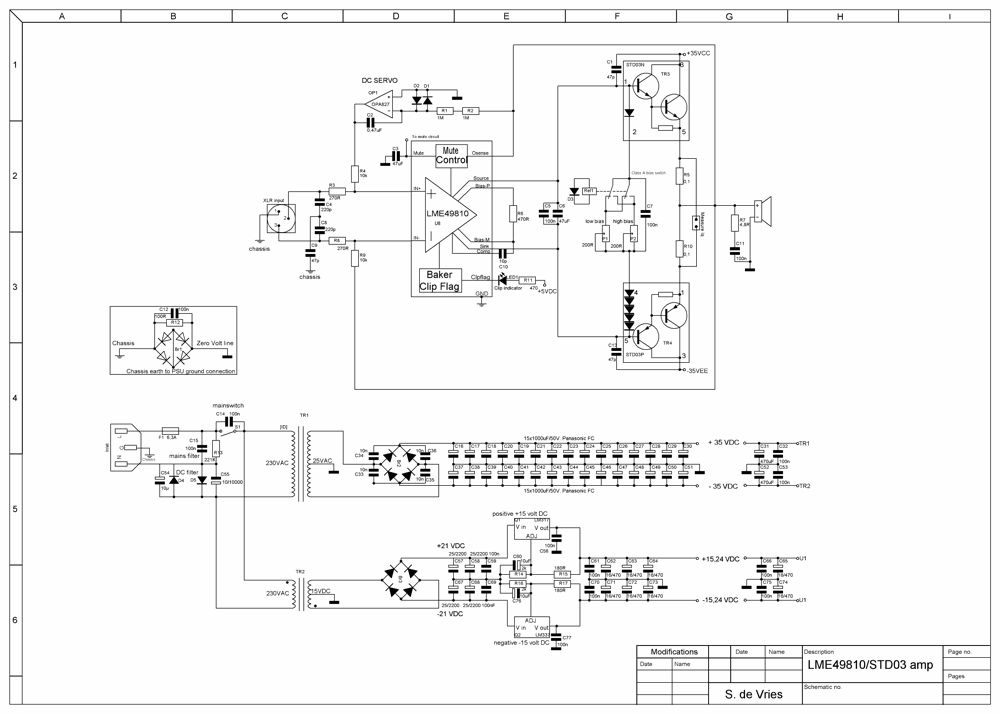

Dear Gianni,
Well the ON-SEMI's have a big benefit that you can actually use the on die diodes in the bias generator since you have access to both sides of the diodes. With the Sankens they are tied internal to the base.
I was very stubborn and ignored the Sanken application note. Namely Bias the system so that you have 2,5mA total through the diodes and 40mA trough the emitter resistors. I attempt to bias the STD03's 10 watt in class A which sounded and measured great! But with such a high bias currents through the diodes the system suffered huge thermal run away and I blow up the output stage. I don't give up on high class A biasing since the sound was so promising. I hope to accomplish this by using an ordinary VBE multiplier in the STD49810 bias circuit to avoid the huge thermal run away. Then bias the sanken's in class A with a potentiometer between the diodes.
I really love the sound of the STED49810 and the sanken STD03's

Dear,
One question for Jan Didden,
In your PAX article I read about the biasing of the STD03's. You advice a voltage drop of 24mV. over the emitter resistor. In your design you use 0,22 Ohm emitter resistors.
Gives me I=0,024/0,22=0,109 109mA bias idle current. More then twice as much as specified by Sanken. You don't have any problems with Thermal run away?
When I biased as high as 0,6A (don't laugh! 😀) I had HUGE thermal run away and the biasing become very dangerous and rised over 1,2A after heat up 😀 But with this high bias the amp sounded really better and THD and IMD dropped on the Audio Precision ATS-1
One last question. How do you measure the voltage drop over the diode string in order to adjust for exact 2,5mA diode forward current? I guess it got wrong there in my experiment.

Dear All,
As promised here the schematics of my try out with the LME49810 and the STD03 Darlington’s.
My new design philosophy is less is more, and I want to use as less as possible components.
The amp turned out to be stable on most speakers without any filter or zobel on the outputs. I couldn’t measure any oscillation. For extra security I added a Zobel filter. I prefer not to use the typical resistor and inductor in series with the output. Listening experiments turned out that I lost my super tight low end with addition of this filter.
I experiment with many power supplies, and the current one with total 30x 1000uF Panasonic FC elco’s gives a significant tighter low end. (To tight for some taste)
I am still surprised about the sound quality results. We compare this simple amp with many expensive respected amplifiers, and in most cases the LME49810/STD03 amp wins hands down in terms of 3D image speed and bass control. Just with a singe pair of transistors it has an awesome control like the bass is constant in a “rails”
Despite the specified 40mA current through the Re’s I added a relays switch which allow me to switch between a lower and a higher bias setting
With PSU of +/-35VDC and 300V/A transformer I measure 50 watt @ 8 Ohm and 100 watt @4Ohm.
I prefer this setup day and night over the LM3886 chip amp designs, which I also build and compared. The air and 3D spatial imaging in the highs is just better then the LM3886, which the later sounded more “compressed” and flat in comparison.
Never change a winning team the say… But in the next experiment I want to try out to add a pair or two pair of STD03’s and add a separate regulated PSU for the LME49810.
The LME49810 is gold in my opinion!
I keep you informed.
With best regards,
Bas
