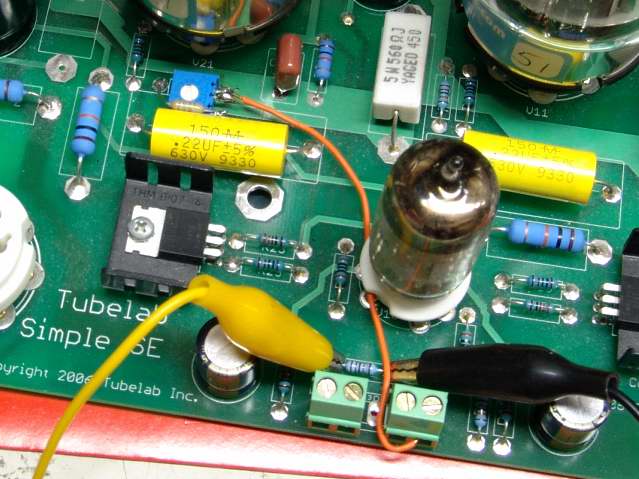

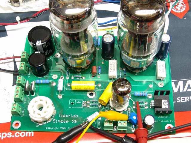

I was suffering some serious tube withdrawals, so I decided to spend my afternoon blowing up some tubes instead of mowing the lawn (we are having record breaking heat). I gathered up a couple of 22 volt sweep tubes, which I planned to wire into a SimpleSE board. I connected a SimpleSE board to a Fluke 407D, and put in my trusty pair of well worn 6L6GC's to test everything out. Then I had a brain flash. Why couldn't I make a push pull amp out of the SimpleSE board? It turns out to be pretty easy, but as with all simple experiments the snow ball started rolling, and my experiment that started at lunch time just finished (10PM) and I never touched the sweep tubes.
The first attempt at making a P-P amp involved using a driver transformer with a center tapped secondary, The UIS-1 from Triode Electronics. The center tap goes to ground and the hot leads go to each channel inputs. I connected a P-P OPT up to the OPT terminals of both channels. When driven with a signal generator the results were good. 20 watts in triode mode, 35 in UL. I connected this up to my CD player, but it sounded bad, real bad. My CD player didn't like being connected up to the transformer, so this experiment was over. I went into the kitchen and got lunch.
I thought about it while eating, and then tried this. I decided to feed the CD player into one channel like normal. Then I made a voltage divider out of the grid resistor on that channels output tube to drive the other channel, sort of a simple paraphase splitter. I replaced the 220 K grid resistor with a 200K resistor and a 20K trimmer pot in series, and wired the wiper to the second channels input. It worked! It worked GOOD!
I was using an 6K ohm OPT that I got from Handwound Transformers (the Lucas guy that ripped everybody off) that has never really sounded good, but I didn't care if I blew it up. I tried triode mode. With 450 volts of B+ I could get about 18 watts at clip. The measured distortion was low, 0.5% at 1 watt and 1.3% at 10 watts. I took out the Chinese 6L6GC's and installed EH KT88's. Power went up to 23 watts at clip. I switched to UL mode. I could get 40 watts at clip. Distortion was 0.2 % at 1 watt, and under 1$ at 20 watts. OK, I cranked the power supply all the way up, 552 volts. Clipping happens at 62 watts. The distortion numbers were even lower. I tried cathode feedback, which lowered the distortion even more, 0.165% at 1 watt, and 1% at 40 watts. The output impedance measured about 2 ohms without any GNFB.
I connected up the CD player and speakers. It didn't sound too good. I disconected the CFB. OK, much better. It sounded pretty good, much better than I expected. Good solid bass, but clipping sounded pretty gross, then again why do you drive a 60 watt amp into clipping?
I have been exploring several different P-P amp designs that will eventually become the SimpleP-P. I really want to come up with a simple P-P amp that sounds a lot like a SE amp with the bass, punch, and dynamics that a P-P amp can deliver. I know that It can be done, because I have an amp with that sound, but it is not simple or low cost (300B P-P). This amp has the simple part down, but the sound is not there....yet.
OK, now I am curious, and I haven't blown anything up yet. Could I manage to rewire the front end of a SimpleSE into a traditional P-P input stage? Didn't sound too hard. Just rip out a few parts, sky wire in a few parts, and now I have a typical input stage, feeding a split load phase splitter. The measured performance was similar to the previous mod, except the output impedance was about 3 ohms, I don't know why. I played with this for a while, but I couldn't make it sound as good as the simple mod. Again CFB sounded gross, and triode sounded better than UL. Time for something really wild!

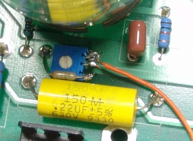

Now that I had made a mess out of a perfectly good working SimpleSE board, I decided to try an idea that has been percolating in my brain for a while. I have recently re-read the paper written by O.H. Schade of RCA in 1938 called "Beam Power Tubes" after reading an article in Audio Xpress by Pete Millett. Both of these articles extoll the virtues of applying local feedback from the output tubes plate to its grid circuit. The claims are triode characteristics with pentode power output. For this to work you need a driver with a relatively high output impedance. This usually implies a pentode. My board has a dual triode. I remembered a post (#54 in this thread http://www.diyaudio.com/forums/showthread.php?s=&threadid=120888&highlight=
that showed a LTP / mosfet cascode. I decided to wire one of these up and apply some feedback to it.
It only took me a few minutes to blow the whole thing up, so I got to do it all over again. This is really an experiment in its initial stages, since it has been alive for about 2 hours. I am running the amp in pentode mode. It makes stupid levels of power, over 75 watts at clip. 4% distortion at 70 watts. 0.2% at 1 watt, output impedance is under 2 ohms without GNFB.

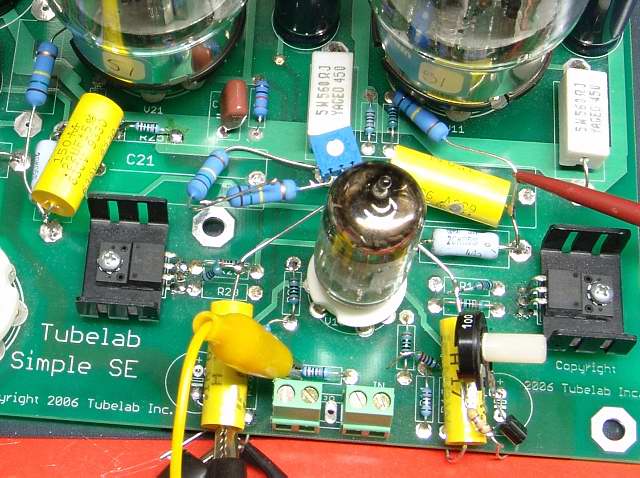

I currently have 150K ohm resistors from the output tubes plate to the mosfet drains, which have 20K resistors to B+. Other configurations remain to be tested.
It was interesting to note that I tried the local feedback approach with the UL configuration. Adding the feedback actually raised the distortion, however the resulting signal sounded quite pleasing with music even though a sine wave looked ugly with up to 10% distortion.
Just make sure you listen to that LTP cascode with the gates ref'd to the cathode node. I've found it a distinct improvement...
Thanks, I think that I have seen you write those words before. I will definitely try it. My last experiment Sunday night was to try injecting some feedback from the output tubes into the gates. The result was a pair of dead fets. It was far too late to be playing around with 550 volts, so I shut it off. I may get some time to experiment further in the coming weekend.
I had about an hour to experiment today, so I replaced the Toasted Toshibas and retried the same experiment at a lower voltage. The reason for the blown fets is a 300 KHz square wave, so I decided to postpone these experiments until I had more time, and more mosfets!

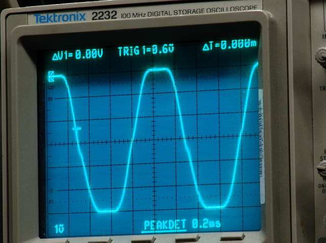

I can't do any listening tests today since Sherri has friends over, but I made some measurements. First off I found out that disconnecting the bypass cap results in the previously mentioned 300 KHz square wave, but no toasted fets this time.
Connecting the bypass to ground results in lower distortion levels below 10 watts (0.4% at 1 watt) but slightly higher numbers above 10 watts. The distortion increases monotonically as you increase power. This is typical for most amps.
Connecting the bypass to the cathodes raises the distortion below 10 watts (0.7% at 1 watt), but lowers it above 10 watts. The distortion is 2.0% from 10 watts remaining almost constant until clipping is seen. I get 2.1 % at 38 watts with a 450 volt supply, and 2.1% at 60 watts with a 550 volt supply.
I have always known that distortion numbers do not always correlate with sound quality. If they did we would all have sand powered stereos. This amplifier and the associated experiments have made this perfectly clear. I will try to do some listening tests on Monday.
The early (simple mod) amplifier with cathode feedback had extremely low distortion numbers (0.12% at 1 watt), but sounded horrible.
The experiment with UL mode created some funny looking distortion at high power but it was almost impossible to make it clip. The distortion went up as I cranked up the drive, no clipping, the sine wave kept getting fatter but stayed round on the top and bottom. It measured bad, but sounded great.
