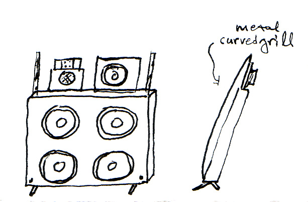

I saw a pair of DQ-10s on e-bay, and got a flashback.
I was a kid when I walked in a proper hi-fi store of the late 70s, and I asked the kind salesman if I could just listen for 10 mins to those great machines that they had on their window.
He smiled and switched some speakers driven by a walnut framed black and silver, floating turntable, connected to a small control unit with right and left volume controls and a hefty black amp. Wow! All was so nice, and then he switched to a weird pair of non box-like, curvy ones, with white grills and oak cheeks.
Those sounded so much more free than the others! They breathed somehow. I still recollect that moment.
Then I started collecting magazines and those things wore actually a Linn LP12, a DNM pre amp, and a powerful Mark Levinson amp, driving Infinity Kappa towers, Linn Isobariks, and Dahlquist DQ-10s in white gown.
Never saw them again since, not even as vintage in someone's hands. They must have not been really distributed in Greece back then. Maybe members of a small import of 'exotic' American models of that era.
Some American forum members must have lived with them or had many listens. Did they really work well? Was there any real science behind that ''phased array'' concept and 5(?) way crossover? Is anybody familiar about their acoustics idea of panels with drivers everywhere behind a grill?
Was that the best speaker in the room, or I just was so little and it was white and curvy?
Here is it with classic black grilles and many photos from one
ebay auction

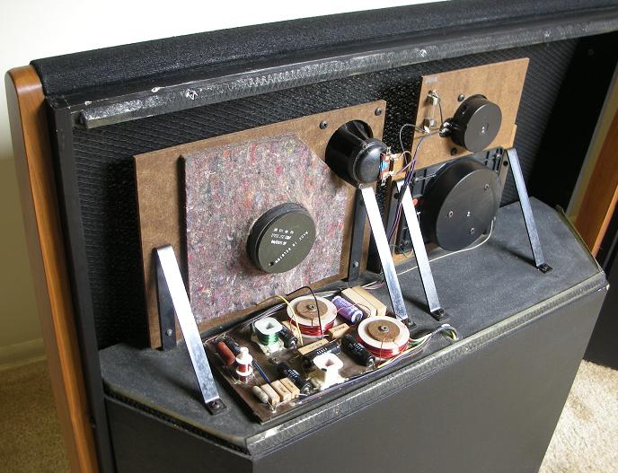

Thank you chrisb. For that era, you confirmed they really had many strengths. I wonder how they worked properly with that complex multi source spread of drivers. Maybe it was the boxless thing, plus back attenuated dipole low mid and closed box lows. I can see that the 4(!) drivers on staggered panels had aligned Z emission points (or at least tried to). The famous speakers back then were big and heavy and vertical. I don't know what Saul Marantz and Jon Dahlquist would have seen for an impulse if they had an FFT back then, but they surely tried over the ESL57 reference and had fresh ideas and good ears. Great vintage stuff!
