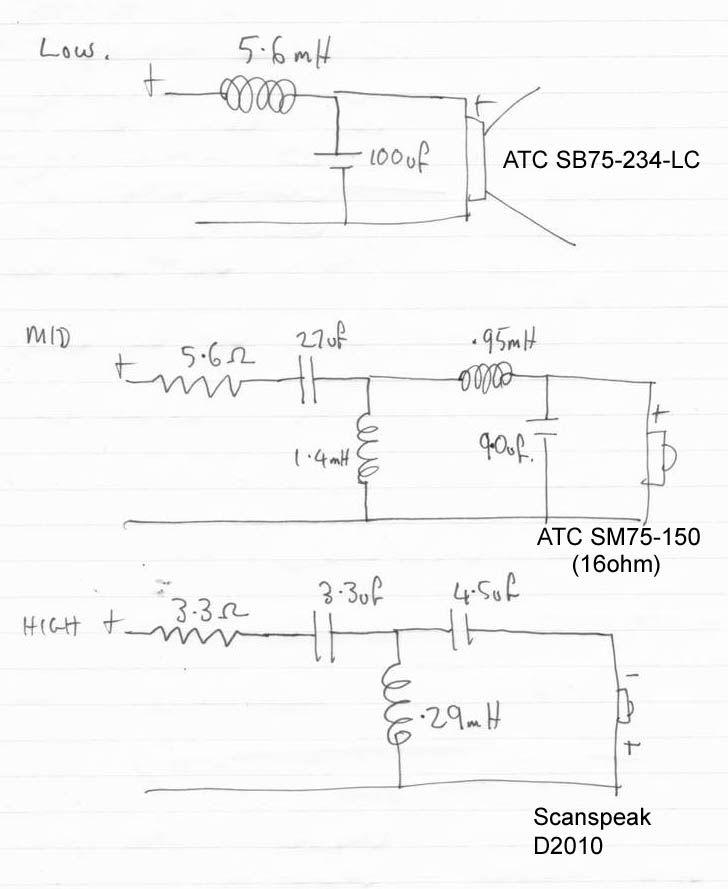

Anybody has the original crossover schematics for ATC SCM 100 or 50?
I know they have impedance correction "up and down" and 12 db slopes "up and down in the 150s, but nothing about tweeter or bass.
Only know the croosover points 380, 3500.

Thanks for posting the xover. Would you happen to know if the mid is the 16 or 8 ohm version? I have an old pair of Proac Studio Towers which was their SCM50 take off - and they used the 16 ohm version of the mid.

Given the values of the components in the zobel and for the series inductor I would guess that it is the 8 Ohm version of the mid.

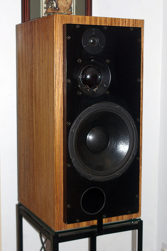

To my understanding the scm50 uses 8 ohm mid sm75 (s version). They are very expensive. Other than sensitivity, both are very high quality, have the same midrange purity and details. Very pleasing to ears.
I have had a pair of brand new 16 ohm of ( non s version of sm75-150 ). I wish to clone scm50 passive xo with different woofer & tweeter.

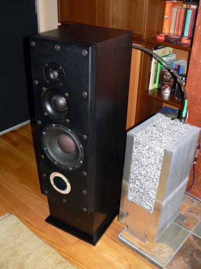

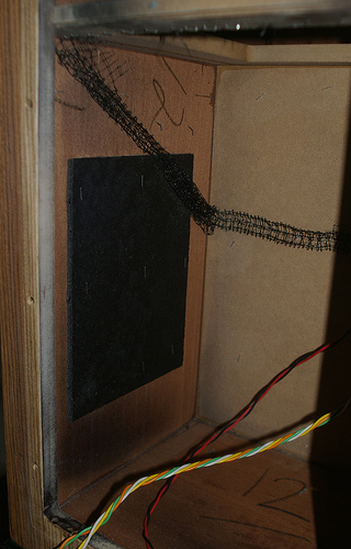

Tamariska - Sounds like you are well on your way. I used the Seas T25C003 - which is what I think ATC uses. It is the the non-ferrofluid version so it is a bit more efficient (91 db).... and not too expensive! Harbeth also uses this model so it must be good eh?

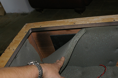

As for the SCM50 box - as stated elsewhere, the "50" denotes it's volume in liters. Also, I think I have read the their box is not internally braced... but I could be wrong. I think also that it is stuffed with insulation... so it may act more like a larger box. Anyway, bracing in my mind is always good..... maybe use the golden ratio for determining position?

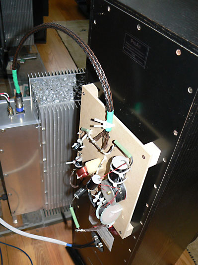

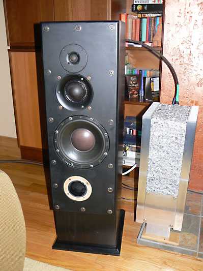

My (modified Proac Studio Tower) box using the ATC woofer is 65L and is braced. I modified it by building a new front baffle out of 3 layers of 3/4" MDF and put in one brace between the mid and the woofer. I'll try and post a picture.
