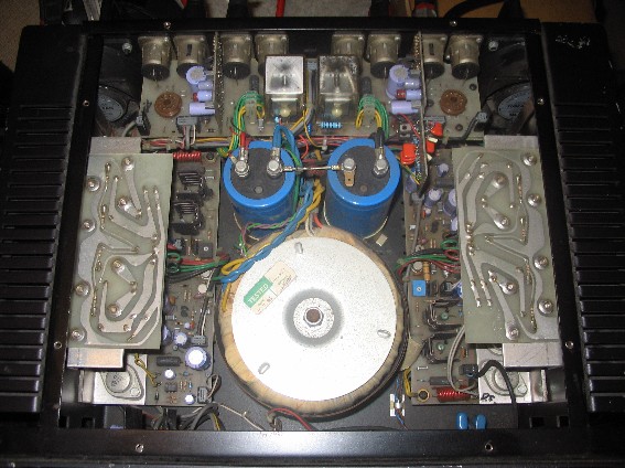

Having searched the forum I found references to lapping heatsinks but no mention of how effective it is or how flat a surface should be.
I'm servicing an old 500W/chan MOSFET amp. I know that heat was a concern with that model.

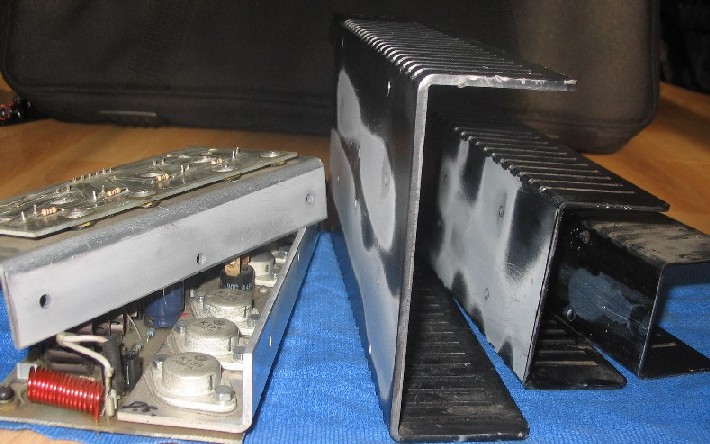

The fets are bolted to an "L" section which is bolted to "U" section, which in turn. has 2 progressivly smaller "U" sections nested inside it. The previous application of thermal grease was unevenly "lumpped" in.
Am I insane to even bother?

There's only one "commercial" MOSFET power amplifier model with a stacked card deck heatsink arrangement i'm aware of.
IMO, glass mirror grinding and China tape will not hack it, you'll need to beef up the heatsinks.
Either by completely exchanging them, or reinforcing the Matryoshka heatsink by adding aluminum bars inserts to make it more rigid.
The angles are too thin (=high thermal resistance).
The heatsink backplate is too thin (=large areas well below temperature of the contact surface of the angles).
This can be much improved to keep the Tc of the transistors much cooler.
Yep, that's the one.
There's plenty room in the L-bracket to add a few holes/bolts for improved thermal transfer, put a slap of thick aluminum on the other side to even out the pressure and you're halfway there.
If you consider the MSRP back then, quite a power amplifier.
